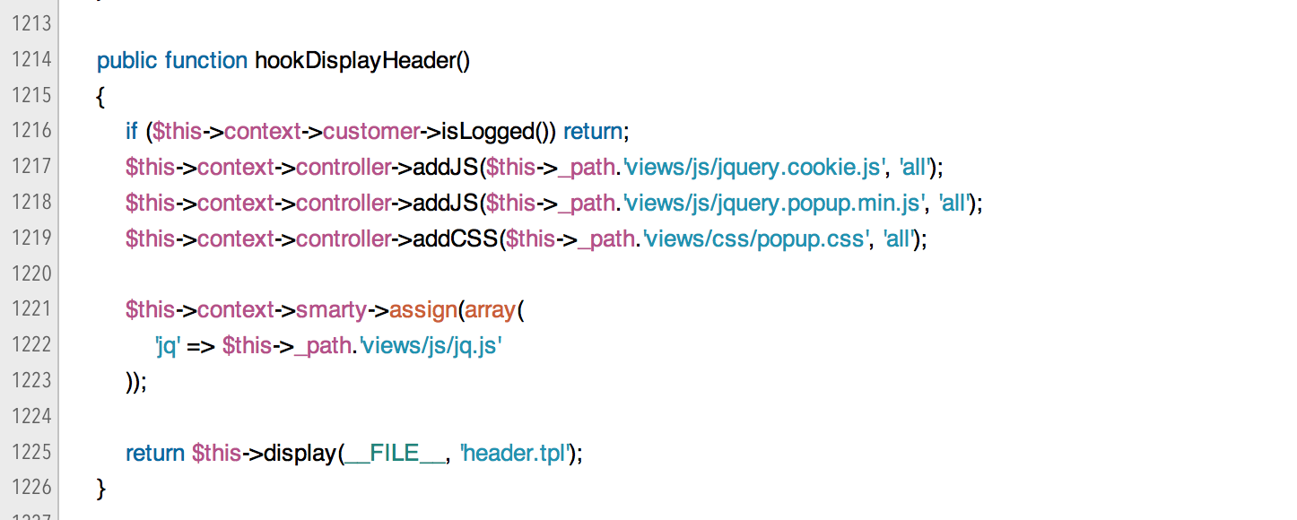

datakick Posted February 17, 2018 Posted February 17, 2018 I haven't tested it, but I think it should be enough to edit hookDisplayHeader, and add this line at the very beginning of this function: if ($this->context->customer->isLogged()) return;
Generaal Posted February 17, 2018 Author Posted February 17, 2018 Hmm thanks Petr for you suggestion, where have you find the hookDisplayHeader? Do I search in the module self or in the global.ccs in the thema?
Generaal Posted February 17, 2018 Author Posted February 17, 2018 I have found it in the custompopup.php And add your suggestion, it works!! Thanks for you quick support, Petr!
