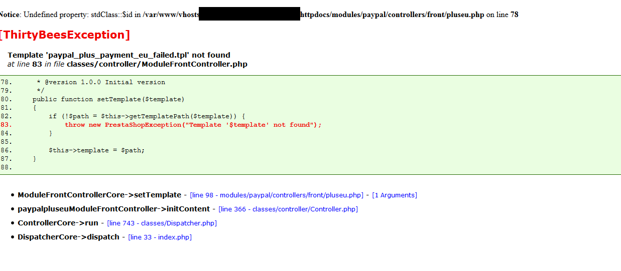

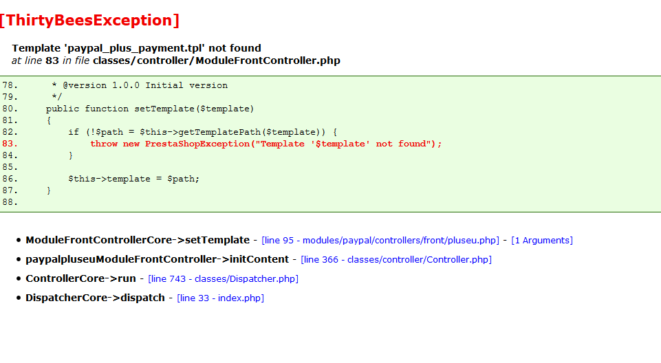

lesley Posted March 8, 2018 Posted March 8, 2018 Try changing this line https://github.com/thirtybees/paypal/blob/master/controllers/front/pluseu.php#L86 to $this->setTemplate('paypal_plus_payment.tpl');
zimmer-media Posted March 8, 2018 Author Posted March 8, 2018 @lesley thank you. I changed the line. Now I get the same error message again.
lesley Posted March 8, 2018 Posted March 8, 2018 The error before was a template error, does the template error still happen?

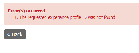

zimmer-media Posted March 8, 2018 Author Posted March 8, 2018 @lesley sorry my mistake -> i forgot to reactivate paypal-plus i have now this error
lesley Posted March 8, 2018 Posted March 8, 2018 Hmm, change that line back, its a different error actually.
lesley Posted March 8, 2018 Posted March 8, 2018 Which paypal module are you using that is making this error, you list both in the first post.
zimmer-media Posted March 8, 2018 Author Posted March 8, 2018 this test with tb 1.0.3 new installed, no migration and paypal 5.3.2
