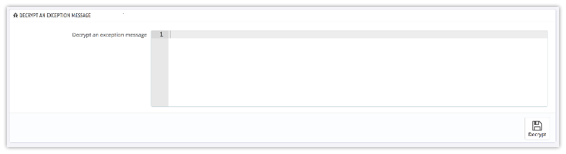

datakick Posted April 26, 2018 Posted April 26, 2018 Error code won't help us, it's encrypted using your server's key. You'll need to paste it to Advanced Parameters > Logs > Decrypt an exception message to get plain version. Then you can decide if it's safe to post it here
30knees Posted April 26, 2018 Author Posted April 26, 2018 Thank you! :) I get the following: ``` ThirtyBeesException Class 'Stripe\Customer' not found at line 119 in file modules/stripe/vendor/stripe/stripe-php/lib/Util/Util.php php 114. if (isset($resp['object']) && is_string($resp['object']) && isset($types[$resp['object']])) { 115. $class = $types[$resp['object']]; 116. } else { 117. $class = 'Stripe\\StripeObject'; 118. } 119. => return $class::constructFrom($resp, $opts); 120. } else { 121. return $resp; 122. } 123. } 124. /** - ThirtyBeesStripe\Stripe\Util\Util::convertToStripeObject - [line 135 - modules/stripe/vendor/stripe/stripe-php/lib/ApiResource.php] - [2 Arguments] php 130. protected static function _create($params = null, $options = null) 131. { 132. self::_validateParams($params); 133. $url = static::classUrl(); 134. list($response, $opts) = static::_staticRequest('post', $url, $params, $options); 135. => $obj = \ThirtyBeesStripe\Stripe\Util\Util::convertToStripeObject($response->json, $opts); 136. $obj->setLastResponse($response); 137. return $obj; 138. } 139. /** 140. * @param string $id The ID of the API resource to update. and more, but it looks like the above is the relevant part.
