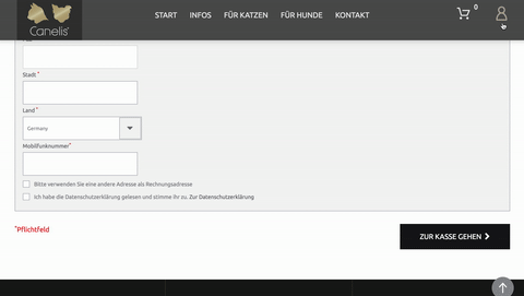

I just realized that some of the Checkboxes in the Art Free GDPR Module won't work. You can click them as much (and as hard) as you want, the just won't check.
https://canelis.de/login#account-creation (At the bottom > "[] Ich habe die Datenschutzerklärung gelesen und stimme ihr zu. Zur Datenschutzerklärung")

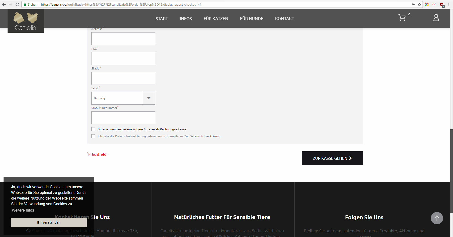

Ah ok, the link above doesn't seem to be the best example. Does this one work? https://canelis.de/login?back=https%3A%2F%2Fcanelis.de%2Forder%3Fstep%3D1&displayguestcheckout=1 Or in other words: When you put somethin in your cart, try to check out and therefore create an accout. Then you have the option to use a different billing address (checkbox works).

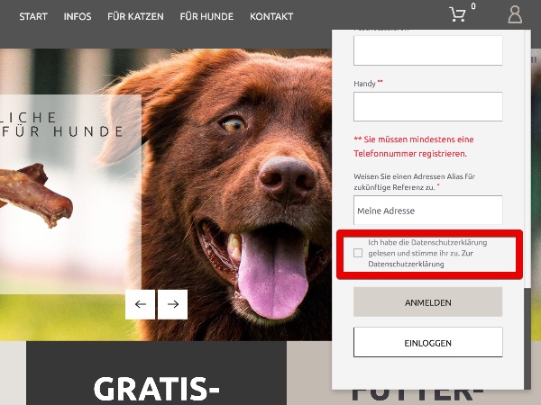

Ahh, I see where the problem is. Your theme has a feature to create account by clicking on person icon in upper right corner. In that case popup window will appear:
This popup window contains this GDPR checkbox as well -- that means that your page contains two html elements with the same id. When you click on the label in your account creation form, you are actually switching state of the other input on the page (inside popup window)

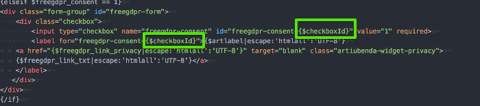

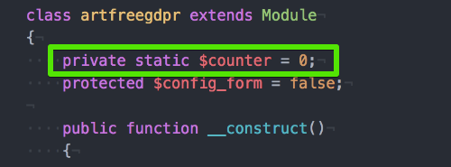

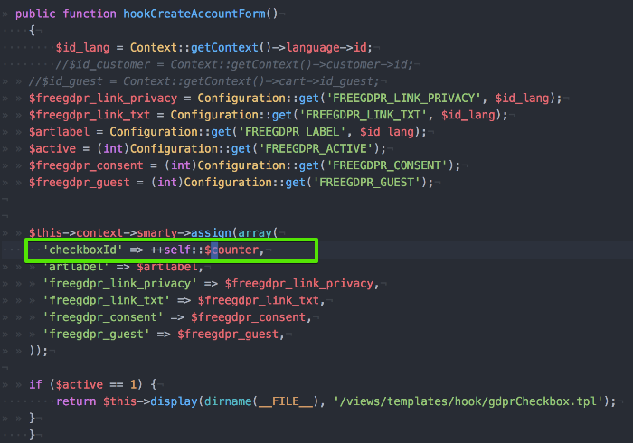

1) create static variable inside artfreegdpr module that counts how many checkboxes were generated during one request 0_1528961142933_edit1.png 2) edit hookCreateAccountForm and hookDisplayCustomerIdentityForm hooks - when hook is called, increase counter and pass its value to template 0_1528961170695_edit2.png 3) use this counter in template itself: 0_1528961245505_edit3.png
