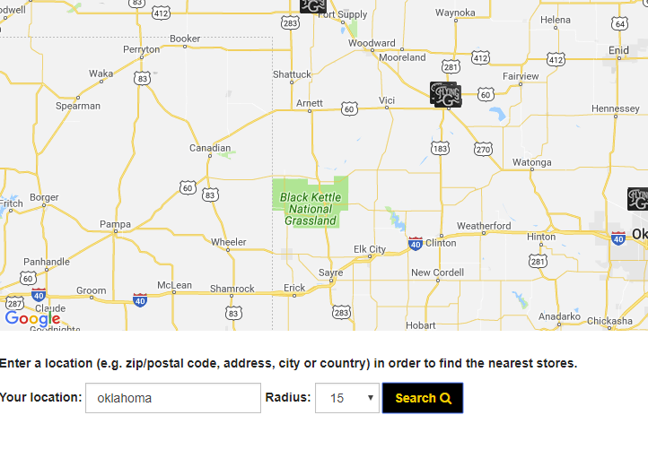

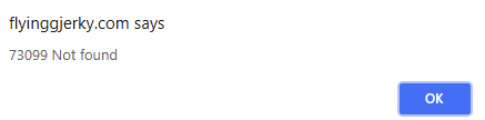

cptplastic Posted July 26, 2018 Posted July 26, 2018 What am I doing wrong when i search for a store within my area it says not found? This is the error i get no mater what i search for.

0 cptplastic Posted February 20, 2019 Author Posted February 20, 2019 You can go see for yourself. https://flyinggjerky.com/store/stores
0 datakick Posted February 20, 2019 Posted February 20, 2019 When you open javascript console, you'll find out this: Geocoding Service: This API project is not authorized to use this API. For more information on authentication and Google Maps JavaScript API services please see: https://developers.google.com/maps/documentation/javascript/get-api-key
