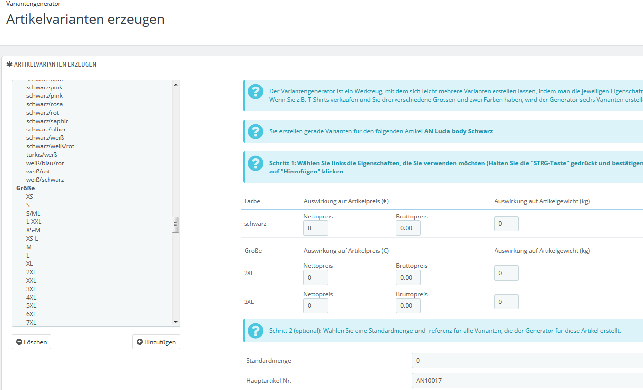

colorful-ant Posted October 18, 2018 Share Posted October 18, 2018 bo -> product -> combinations you can also use the "product combination generator" in order to automatically create a set of combinations. its a little bit faster to creat, if you have all attributes in your list - or better import with csv combination generator Link to comment Share on other sites More sharing options...

the.rampage.rado Posted October 18, 2018 Share Posted October 18, 2018 As I said you have to understand that 'combination' is different from 'attribute'. One combination can have one or multiple attributes. And if you had one combo with one attribute and then you decide to add second or even third attribute the system considers this to be brand new combination and leaves you to input your brand new stock. As if I had one pair of jeans with size S, M and L... Firstly I stocked only blue but later the manufacturer rolled out them in pink aswell - I decide to stock them too and use the current product in my shop. As @colorful-ant showed above I can use the combination generator to ease my work and add the new color which will leave me with 6 combinations - blue SML, pink SML... All of which will have 0 quantity because the system can't know what you have altered in your combination and in order to prevent stock levels issues it simply delete all available stock from those combos. This message you receive in the product page is when you have size L and size S let's say and you select from the dropdown list a combination without stock available for sale. The system hides the button and displays that message. If you run out of stock of all of the combos the message will be different and again with hidden button. Link to comment Share on other sites More sharing options...

dan.cretu Posted October 18, 2018 Author Share Posted October 18, 2018 Yupiii, I managed to solve this problem using "product combination generator", which attributed my product size to their color. Now I turn on "Add to cart". I'm going to get you to a beer with the aroma of Transylvania mountain's. You do not know how happy they are. There are always people willing to help you on this forum. Once again thousands of thanks, Mr the.rampage.rado and the colorful ant. Link to comment Share on other sites More sharing options...
the.rampage.rado Posted October 18, 2018 Share Posted October 18, 2018 The generator is no different than manually adding the combos... it simply speeds up the process. Good luck with your project from Sofia! :) Link to comment Share on other sites More sharing options...
