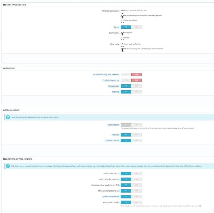

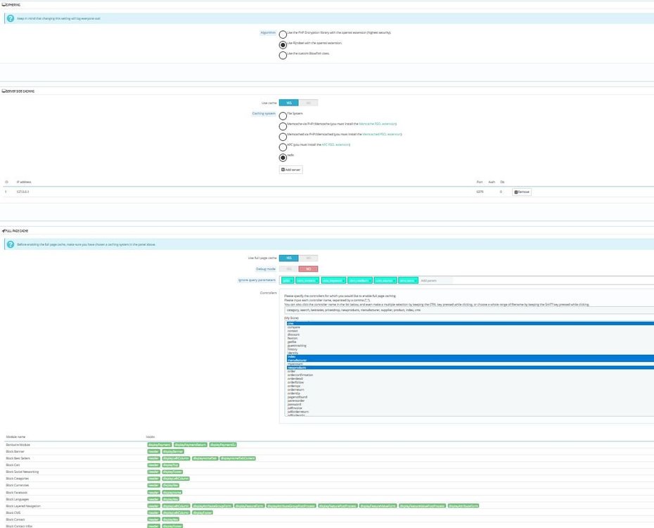

Smile Posted January 24, 2019 Posted January 24, 2019 I have checked https://docs.thirtybees.com/installation/ for the server requirements and did not find it very exciting 😉 We have installed a plain brand new thirty bees. But I found it very slow... >4000 ms  I have attached the statistics and cache settings used... I am wondering can I do more? Because I expect I do something wrong on this test site. We run on a VPS. Speed-debug-report.pdf

lesley Posted January 24, 2019 Posted January 24, 2019 That should be fine, is opcache running on your server?Â
lesley Posted January 24, 2019 Posted January 24, 2019 Oh, also, debug mode and debug profiling should not be run during speed tests...Â
Smile Posted January 24, 2019 Author Posted January 24, 2019 Opcache was not running I did enable it now.Â
