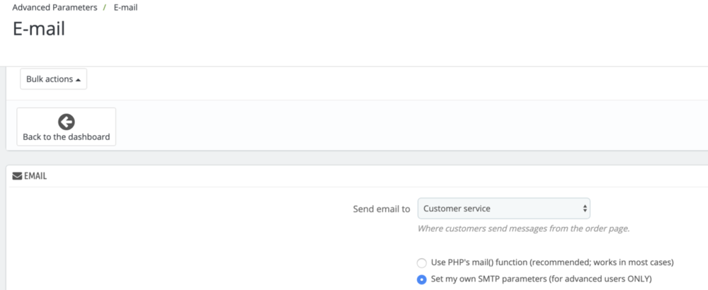

My email account is with microsoft office 365, and is the same domain as my site. My email was configured with "Use PHP's mail() function". This has been working fine since Christmas when the site went live, but as said, just stopped working on the 4th of May.
I tried switching the customer services email to a gmail account and it comes through just fine, switch back to my domain email with 365 and it stops again. I contacted microsoft and they said to switch it over to SMTP but that refuses to even connect.

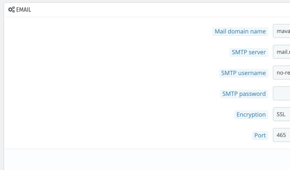

Hi Brent, thanks for the reply, yes thats pretty much what the Microsoft technician said, but for some reason it's not accepting the SMTP details.
It says "Unable to connect with TLS encryption"
And i know the username (email) and password are 100% correct.
I used microsoft 365's SMTP's settings of
Server name: smtp.office365.com
Port: 587
Encryption method: STARTTLS

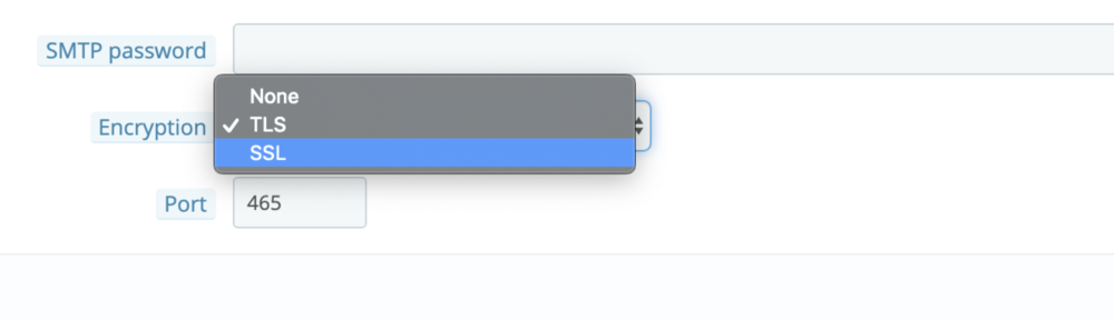

But obviously I can only select TLS, not STARTTLS 🙂

Hi Brent, just switch to SSL and getting this error now 🙂
Error: Please check your configuration
Connection could not be established with host smtp.office365.com [ #0]
