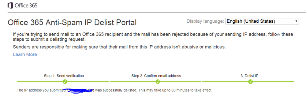

Okay, so I've spoken to MS and he gave me a link https://sender.office.com/ to de-list the server so fingers crossed it's all going through :)
On 6/5/2019 at 3:30 PM, Brent Dacus said:
I wouldn't use PHP sending.  Alot of places block that as spam.
Yep. I some how felt it would come to this. In this day and age php mail really shouldn’t be an option.  MS will hopefully delist your IP within 48 hrs.

Okay, I've tried a few times via SMTP not and it's still having none of it. Switch back to PHP and it's now working as it used to??
So they unblocked you? Already
did the server guy fix the reverse mail and the dmarc as well
