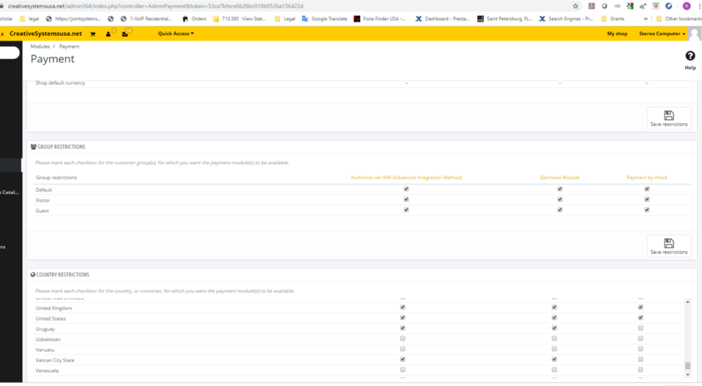

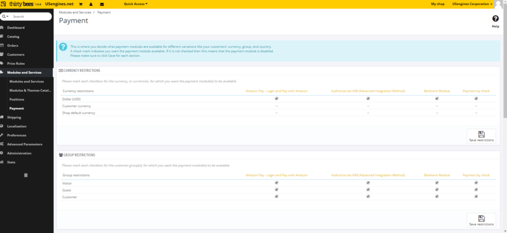

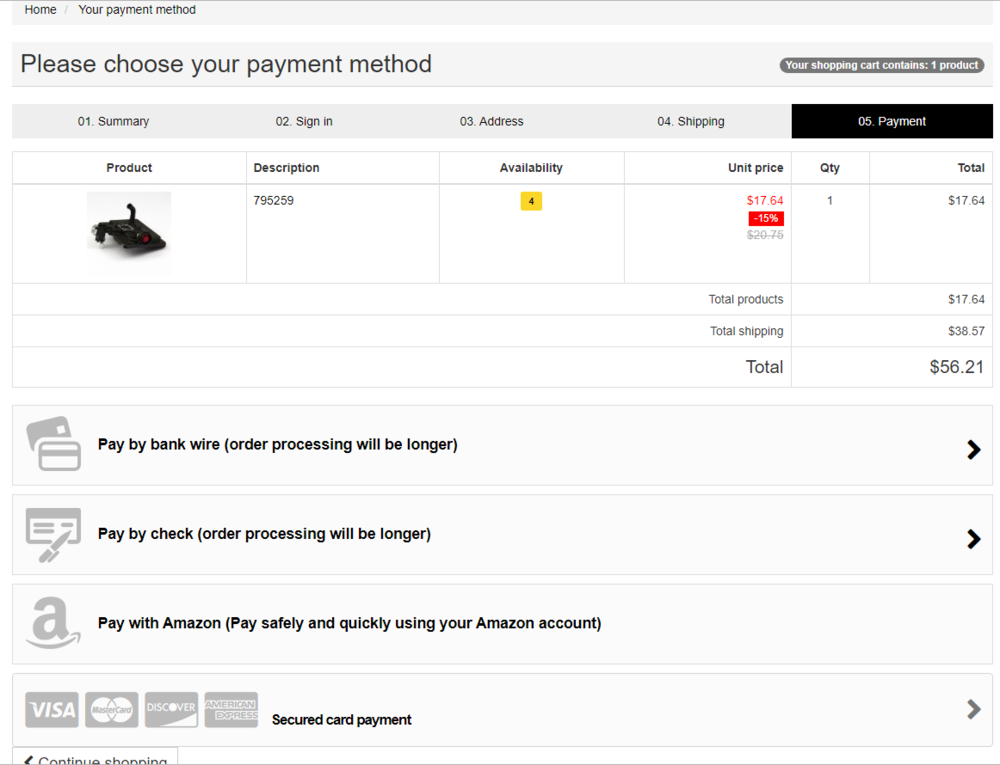

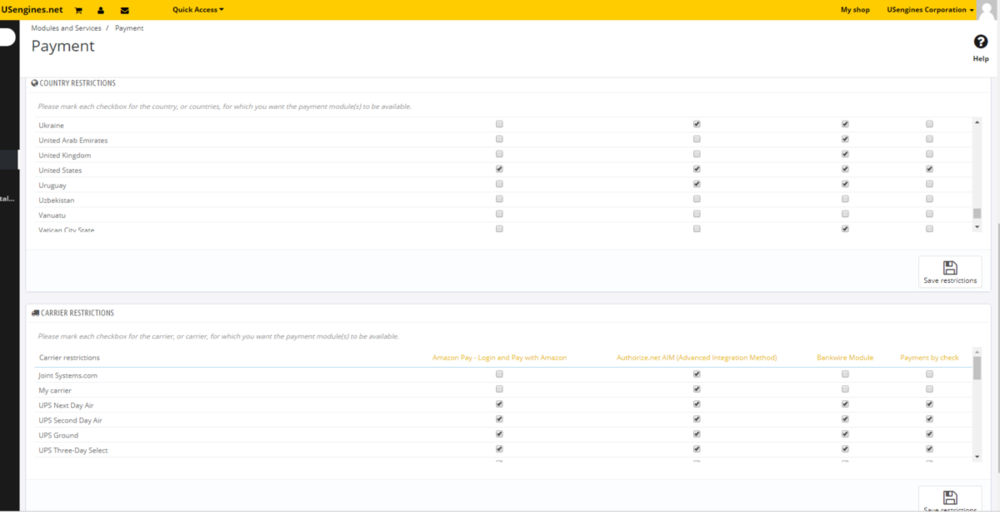

USengines.net secure checkout choice appears but when you click on it, the page jumps to top and no form appears.  Authorize Aim 2.0 is configured with all four cards selected, payment module configured.  Tried numerous performance settings same result.  Tried resetting Authorize Aim, uninstalled and reinstalled authorize Aim same result, at first had no CC choice at all.
Though version 1.08 was installed ran Core Updater.  This fixed the problem with the non functioning secure checkout as the form now appears where you add name CC number, expiration date and security code.  The traansadtion will now run however you end up with Authorize.net returned a malformed response, aborted on all our Hostwinds sites.
