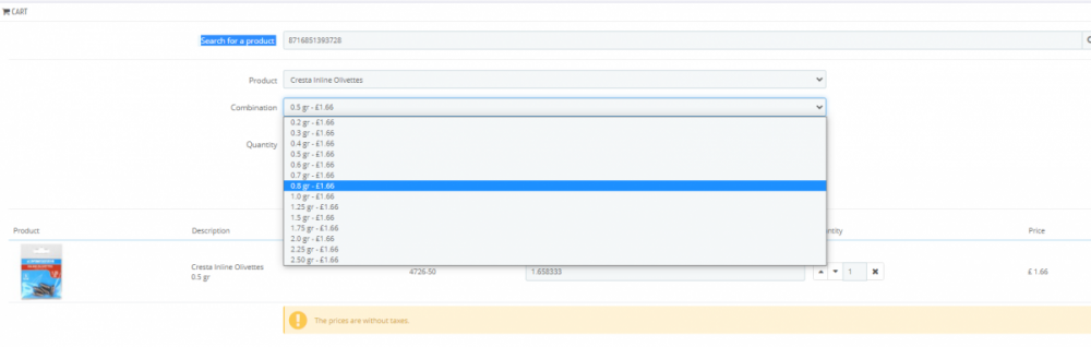

When I go into orders / create new order' I scan a product and it always loads the default product when combinations are present which is kinda strange as the correct barcode numbers are loaded and visable on the screen, sure you can use the drop down to select the correct product but that would make the scanner a slower option.
In the image below in the search for products box  the EAN code is for the item weighing 0.8g  yet its loaded and when added adds the default 0.5g
Anyone have any thoughts on this? obviously you have to have a default or at least a starting point for customers to place orders  this just seems a bit wierd that you scan a specific product code and it loads something else

I have never tried it with a barcode, but the normal search is broken in some way. it rarely happens, but sometimes it search the product and shorty after reloads the whole list. Tbh I don't think this to cases are related. In your case this feature is probably just missing. I guess nobody thought on an EAN search like that - even tough it makes sense 🙂
I could imagine that it fails for reference too. But I haven't tested anything...
