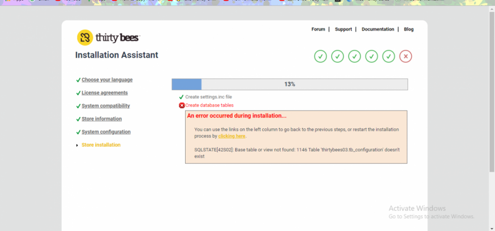

netamismb Posted January 12, 2021 Posted January 12, 2021 (edited) I tried to install a new thirtybees project on local machine (windows 10 with WSL2) using current version from master branch, but i get errror Create settings.inc file Create database tables Create default shop and languages Populate database tables Configure shop information Install demonstration data An error occurred during installation... You can use the links on the left column to go back to the previous steps, or restart the installation process by clicking here. Uncaught Error: Call to undefined method Attribute::hydrate() in /mnt/d/localdevelopment/thirtybees/install-dev/classes/xmlLoader.php:526 Stack trace: #0 /mnt/d/localdevelopment/thirtybees/install-dev/classes/xmlLoader.php(362): InstallXmlLoader->createEntity('attribute', '12_oz', 'Attribute', Array, Array) #1 /mnt/d/localdevelopment/thirtybees/install-dev/models/install.php(889): InstallXmlLoader->populateEntity('attribute') #2 /mnt/d/localdevelopment/thirtybees/install-dev/controllers/http/process.php(268): InstallModelInstall->installFixtures(Array, Array) #3 /mnt/d/localdevelopment/thirtybees/install-dev/controllers/http/process.php(104): InstallControllerHttpProcess->processInstallFixtures() #4 /mnt/d/localdevelopment/thirtybees/install-dev/classes/controllerHttp.php(207): InstallControllerHttpProcess->process() #5 /mnt/d/localdevelopment/thirtybees/install-dev/trystart.php(34): InstallControllerHttp::execute() #6 /mnt/d/localdevelopment/thirtybees/install-dev/index.php(56): require_once('/mnt/d/localdev any hints what goes wrong? The error occurs to install demonstration data, would be safe to just delete the install-dev folder and add manually some data? Edited January 12, 2021 by netamismb
netamismb Posted January 13, 2021 Author Posted January 13, 2021 Trying to install the project without demonstration data, I get: An error occurred during installation... You can use the links on the left column to go back to the previous steps, or restart the installation process by clicking here. Table 'thirtybees_test.tb_attribute' doesn't exist
datakick Posted January 13, 2021 Posted January 13, 2021 This is related to php8 and it's Attribute class. Even if you don't run on php8 there is already a polyfill that introduces this class, and that breaks the whole tb store. I'm currently working on this issue, it will be fixed soon. 2
datakick Posted February 6, 2021 Posted February 6, 2021 This looks like a database permission issue. Maybe you don't have rights to create new tables
netamismb Posted February 6, 2021 Author Posted February 6, 2021 Check if the mysql user has SELECT, INSERT, UPDATE, DELETE, CREATE, DROP, ALTER rights. 1
