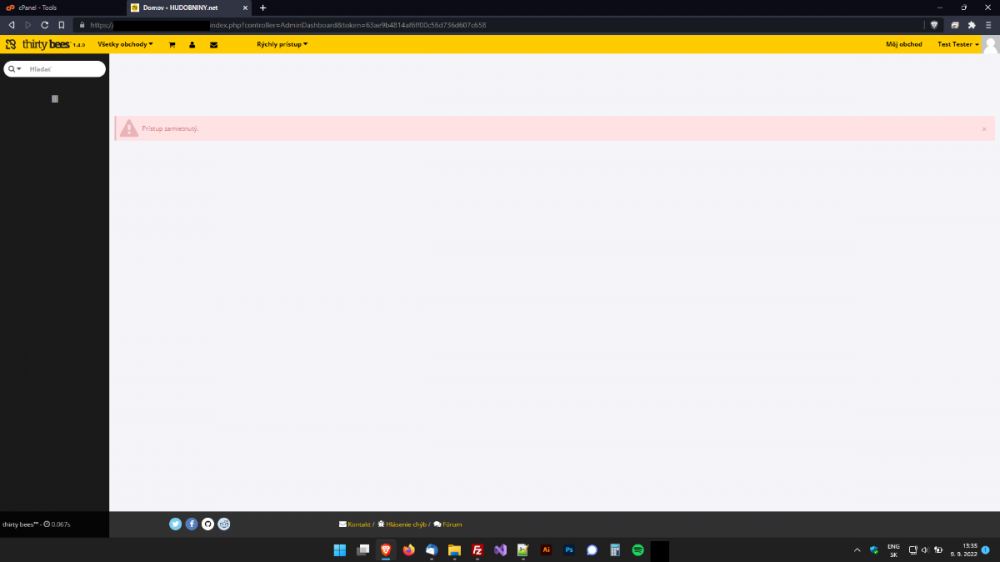

pauld Posted September 9, 2022 Posted September 9, 2022 When non SuperAdmin employee login (with rights to display dashboard) Access forbidden error is shown. This only happens on PHP 8.1. Does anyone else have this issue? Can someone reproduce?
datakick Posted September 9, 2022 Posted September 9, 2022 I've reproduced this. Nasty issue, actually. This is caused by https://www.php.net/manual/en/migration81.incompatible.php#migration81.incompatible.pdo.mysql DB driver in php8.1 returns integer and decimal number values from database as integers and floats. In previous php versions, the return values were simple strings. So, sql query SELECT * FROM tb_access WHERE id_tab = 1 AND id_profile = 2 used to return data [ 'view' => '1', 'add' => '1', 'delete' => '1', 'edid' => '1' ] But in PHP8.1 it returns [ 'view' => 1, 'add' => 1, 'delete' => 1, 'edid' => 1 ] Couple this change with strict comparison operator: if ($access['view'] === '1') { // ... } And we have a huge problem.
