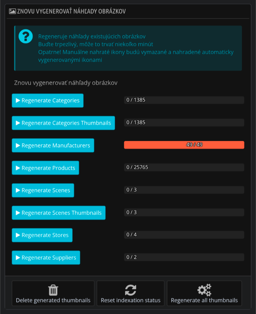

  1. Hi, in administration go to: Preferences -> Images. Then regenerate images.

  3. We have a large product catalog and use our own synchronization solution. To handle product images, our solution generates them on our own server instead of the VPS or web hosting environment. It then uploads the images in the required dimensions and formats (webp, avif) to the thirtybees img directory and creates the corresponding database records. This way, we avoid using web host resources for image generation and achieve better image quality and compression. Our solution is currently built for our specific ERP system and environment, but maybe there is some similar solution available for your environment?
