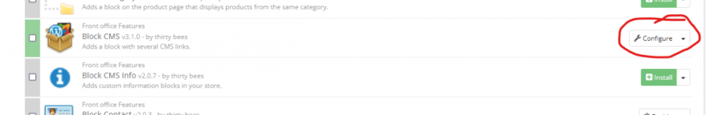

0 AABFM Posted March 20, 2023 Posted March 20, 2023 (edited) Inside the "Information" block which, I beleive is the CMS bit of TB: However when you go to the CMS management (Preferences -> CMS) there is no such thing: In the meantime I also tried to Disabled it, Uninstall it and even Delete it from within the admin menu and... Nothing! This is how it currently is: Just in case, I've also tried IE and Opera as different browsers (I use FF) and... Nothing! Any ideas? Thanks Edited March 20, 2023 by AABFM

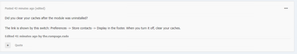

0 the.rampage.rado Posted March 20, 2023 Posted March 20, 2023 (edited) Did you clear your caches after the module was uninstalled? The link is shown by this switch: Preferences -> Store contacts -> Display in the footer. When you turn it off, clear your caches. Edited March 20, 2023 by the.rampage.rado

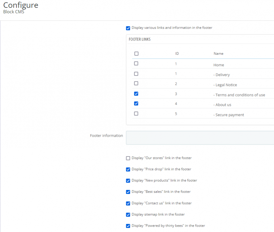

0 e-com Posted March 20, 2023 Posted March 20, 2023 On 3/20/2023 at 11:34 AM, AABFM said: Inside the "Information" block which, I beleive is the CMS bit of TB: Expand "Block CMS" module configuration: Configuration of the various links in the footer 1

0 AABFM Posted March 20, 2023 Posted March 20, 2023 Found the solution! 1. Edit the Bliock CMS by clicking in "Config": 2. Inside click on "Edit" on the "Left Blocks": 3. Set as "No" "Add link to Store Locator" Done! Thanks to all of you!
0 the.rampage.rado Posted March 20, 2023 Posted March 20, 2023 OK but this is the 'column' block so basically we were right but you fooled us the whole time! π π π I saw your initial screenshot as part of your footer. π
