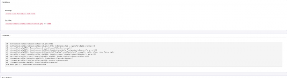

Enable debug mode and (or) install collectlogs module. That will tell you what's wrong.
Probably some module that is using Attribute class. That was renamed in 1.4 for php8 compatibility reasons
That does look to be the issue, how would I go about getting that to work?
I've attached the screenshot below of the message.
