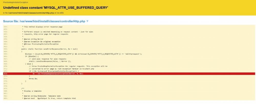

MaxStrax Posted July 12, 2023 Author Posted July 12, 2023 (edited) I finally got it working. Seems I was forgetting to include a php extension while building the image. But, the main reason was a file/folder permission error. Sorry about that. Totally, my fault. But, now I see this error message: Edited July 12, 2023 by MaxStrax
MaxStrax Posted July 12, 2023 Author Posted July 12, 2023 (edited) This is the Dockerfile I use to create the php-fpm image: FROM php:8.1-fpm # Instalar dependencias y módulos PHP necesarios RUN apt-get update && apt-get install -y \ libzip-dev \ libfreetype6-dev \ libjpeg62-turbo-dev \ libpng-dev \ libonig-dev \ libxml2-dev \ libpq-dev \ && docker-php-ext-install -j$(nproc) \ bcmath \ gd \ intl \ pdo_mysql \ soap \ zip RUN docker-php-ext-enable gd RUN docker-php-ext-configure gd --with-freetype --with-jpeg # Habilitar OPcache RUN docker-php-ext-enable opcache # Configurar el archivo de configuración de PHP #COPY php.ini /usr/local/etc/php/conf.d/custom.ini # Establecer permisos adecuados para el servidor web RUN chown -R www-data:www-data /var/www/html/ Edited July 12, 2023 by MaxStrax
MaxStrax Posted July 12, 2023 Author Posted July 12, 2023 (edited) Ok. SOLVED! FROM php:8.1-fpm # Instalar dependencias y módulos PHP necesarios RUN apt-get update && apt-get install -y \ libzip-dev \ libfreetype6-dev \ libjpeg-dev \ libpng-dev \ libonig-dev \ libxml2-dev \ libpq-dev \ && docker-php-ext-install -j$(nproc) \ bcmath \ intl \ pdo_mysql \ soap \ zip RUN docker-php-ext-configure gd --with-freetype --with-jpeg RUN docker-php-ext-install gd RUN docker-php-ext-enable gd # Habilitar OPcache RUN docker-php-ext-enable opcache # Configurar el archivo de configuración de PHP #COPY php.ini /usr/local/etc/php/conf.d/custom.ini # Establecer permisos adecuados para el servidor web RUN chown -R www-data:www-data /var/www/html/ Edited July 12, 2023 by MaxStrax
