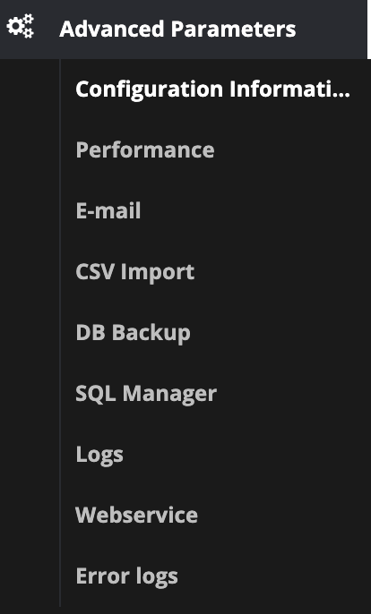

My Advanced menu doesn't give me Disable non thirty bees modules option
