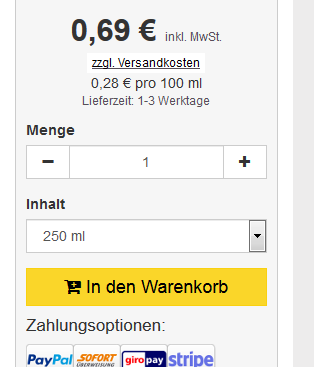

@unica-e-shop I do not know if it will help you or others this. AND its not your question. On the product page you have in the view double plus and minus button double in the display.
for example on standard theme and others 0_1522024596552_7da94733-3f04-455b-9e37-901ba36b3fd7-grafik.png

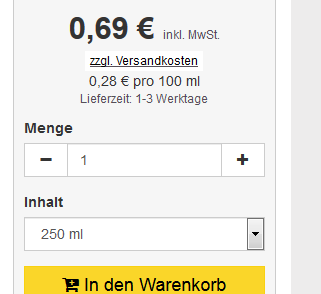

go to your theme and change in your product.tpl from <input type="number" min="1" name="qty" id="quantity_wanted" class="text text-center form-control" value="{if isset($quantityBackup)}{$quantityBackup|intval}{else}{if $product->minimal_quantity > 1}{$product->minimal_quantity}{else}1{/if}{/if}" /> to <input type="text" min="1" name="qty" id="quantity_wanted" class="text form-control" value="{if isset($quantityBackup)}{$quantityBackup|intval}{else}{if $product->minimal_quantity > 1}{$product->minimal_quantity}{else}1{/if}{/if}" /> result without double plus and minus button 0_1522024808980_f2bec3a6-3c31-4851-822e-2264f7c2bdb1-grafik.png
sorry my mistake - i forgot text-center

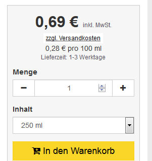

<input type="text" min="1" name="qty" id="quantity_wanted" class="text text-center form-control" value="{if isset($quantityBackup)}{$quantityBackup|intval}{else}{if $product->minimal_quantity > 1}{$product->minimal_quantity}{else}1{/if}{/if}" /> 0_1522025495336_bbc9dba2-2b08-4e86-b9a5-e30cd5b6c91c-grafik.png
