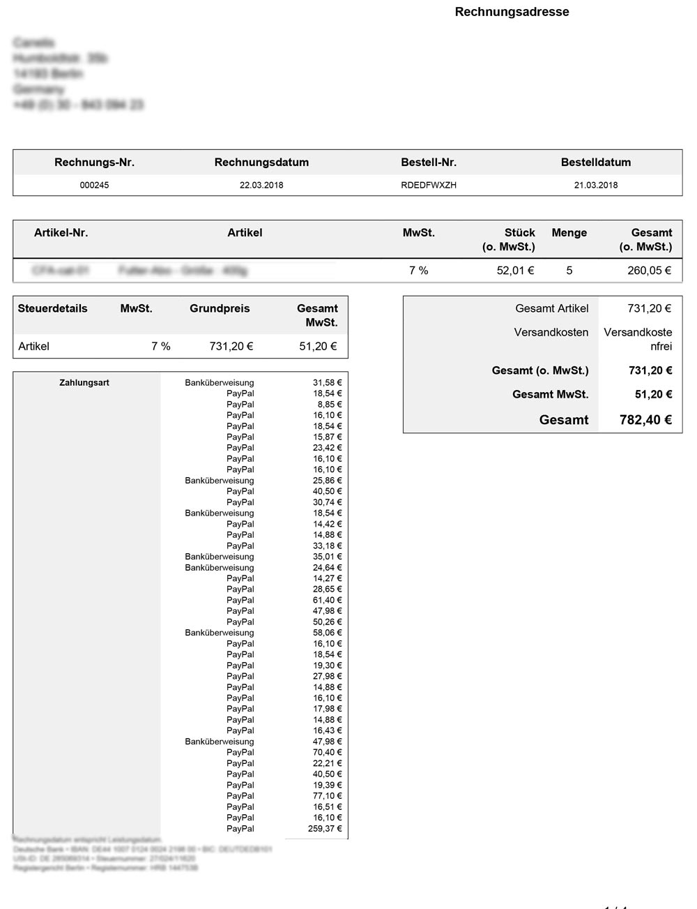

Good morning,
I have an invoice issue. Some information is missing like the customer's address or the logo. Other lines seem to take the data from ALL orders like the payment method.
They were displayed correctly a few days ago and I think the only thing that could have effected them should be the migration/import of old customers and orders. But looking to the backoffice, they "should" have been imported correctly.
Any ideas? :D

That is correct. It's a migration-shop, so I wanted to play it save somehow. But I'm not sure it's about PayPal since other stuff is missing, too. And the example above is via bank wire.
so its a core issue.. weird. Saidly I dont think it's possible to recreate this error, it just seem to be random. @mdekker needs to look into it, but without being able to reproduce the error, its going to be impossible to fix. :smirk:
It looks the same as yours, but It's too long to show, it was a 5 page order, with 17 pages of Payment Method... The only thing different about it is, that on page 4 it shows the correct total, with two of those payment methods showing. Then the next page it whose the total for 1 product, then 17 pages of payment method.
My invoice goes over ~5 pages, but I only posted the first one :D
Did you start your shop from scratch, or did you also import customers and orders?
@SLiCK_303 so we have in common that we both imported customers etc? How did you do it? Directly via database?

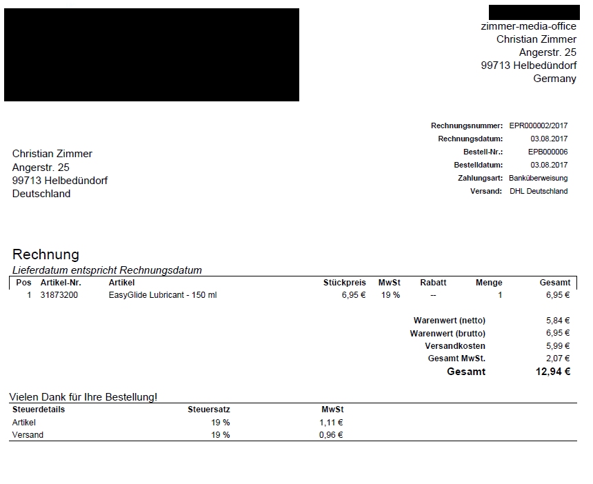

@zimmer-media thanks, but the problem isn't the template itself. It's more about how it's filled.
@manisch
Yes I did see it. First and foremost, I would assume that the assignment of the ID's in the database runs together here. eg in the table invoice payment or so etc. - same ID's.
Hmm, I though I checked it. At least I took a look at tb_orders and it seemed fine to me. Every order still has it's own, unique ID and it's not like a customer can see every order of everyone ever made.
But on the other hand I can only explain this error by some wrong linked database entries. I just don't know where and how to check...

@zimmer-media Still looks fine to me, but I'm no expert in databases. All ID and order-references are unique :/
@SLiCK303 I actually kept the ps prefix. I tried to import the databases but hat troubles to get logins working, even with changing the keys. In the end I used Store Manager for the import. Is your Logo and customer address missing, as well?
@manisch this really seems like some data integrity problem caused by botched data import. I'd guess data from different tables were incorrectly paired, possibly referencing non-existing documents. I could have a look at your data to confirm this, but it probably won't help you much. It would be hard to fix the data in place - it's probably better to do the import again.
