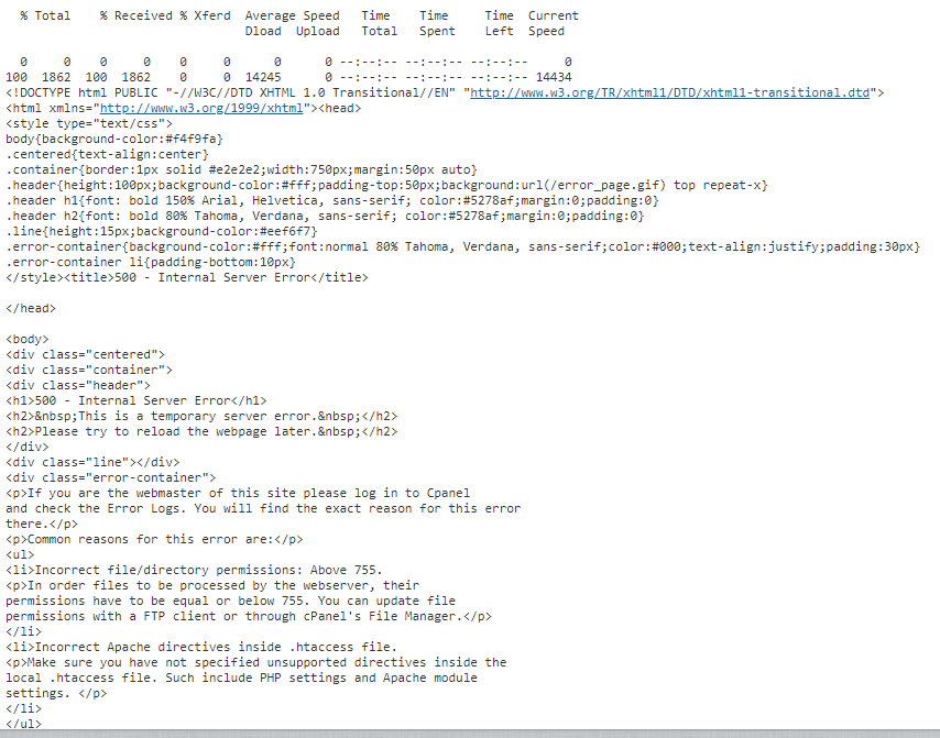

Result cron on Cpanel curl -K without quotes : [2018-05-11 16:50:01]: error: directory is writable by others: (/home/mqujxhzg/public_html/modules/sendreviewrequest 0_1526050684939_Screenshot_1.png

If you just run your cronjob on the browser you will see the full error. As I can see the problem is not with your cron task or cron module, but it with the cron.php inside the module sendreviewrequest. Dont forget to disable debug mode.
I installed the Birthday module and got the same problem so it is not cron.php inside the module. Run the crojob on the browser gave a 500 internal server error, Incorrect file/directory permissions: Above 755. Checked the module and all permissions after install the module where set to 777. Changed the permission for the directory to 755 and the cronjob runs. Why is the permission after installing these modules 777 or is this always the standard permission for install new modules?
