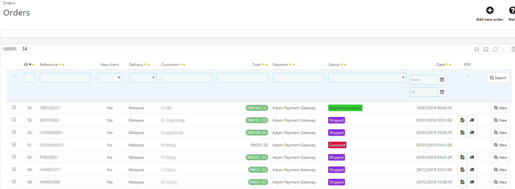

Hi,
I have received an order that has been paid for. The status has been updated to payment accepted. Normally, a document symbol will appear by the order that allows me to download an invoice. This is missing.
I can create an invoice by selecting 'Generate PDF Invoice by Date' using the invoices tab. However, the invoice only lists one of the 15 purchased items. Unfortunately, the customer has received this incorrect invoice through email.
Is it possible to manually delete this invoice from the system and create a new one manually?
I also had another issue where one order was created twice. I cancelled the order as shown in the screenshot. However, it messed up my inventory because when I cancelled, the items were added back to the stock even though they had already been updated by the first order. So I had to manually remove the items from the stock.
Any help would be greatly appreciated.

Hi,
Just to update. I believe I have figured out how to fix the problem manually. The values in entries in two MYSQL tables were blank:
  • tborders.invoicenumber contained a 0. I entered the correct invoice number from tborderinvoice.idorderinvoice
  • tborderdetail.idorderinvoice for all the purchased products also contained 0s. I added the invoice numbers to all the products.
I would really appreciate input from someone who understands the coding. First of all, when is the invoice number added is it when the status is changed to payment accepted or once the order has been placed? Are there any other entries to check that I haven't thought of that may not have been written to the database? Are there any implications for changing these numbers manually? What could cause this glitch?
Any help would be greatly appreciated. Thanks so much.

Just in case anyone reads this in the future, this was actually an Adyen Payment module that was causing the issues. Nothing to do with Thirty Bees. Is there a way to mark this a closed or solved?
