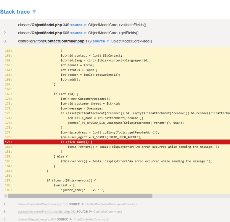

x97wehner Posted October 14, 2019 Author Posted October 14, 2019 (edited) in debug mode I get this error: "Property CustomerMessage->user_agent length (129) must be between 0 and 128 in file classes/ObjectModel.php at line 1058" - Not sure how to fix. Please help Edited October 14, 2019 by x97wehner

yaniv14 Posted October 15, 2019 Posted October 15, 2019 I don't think there should be a limit of 128 chars for user agent. But you can truncate the user agent to 128 chars like this: substr($_SERVER['HTTP_USER_AGENT'], 0, 128). Anyway I don't think that this kind of information is valuable to you because you probably use GA or other tools to collect this data.
datakick Posted October 15, 2019 Posted October 15, 2019 This error occurs because your browser user User Agent string is too large (129 characters) and database column can store only 128 characters. Current version of thirtybees silently ignores this, and database automatically truncate the string to 128 chars. In this particular case it's not really important, because who uses this field, right? But in general, this silent truncation is a bad thing, because it can lead to unwanted data loss. The question is what the right fix should look like we can increase column size for this field in CustomerMessage object model we can do explicit truncation as @yaniv14 suggested (probably better to use multibyte version of substr function) or we could introduce some new Object Model Field meta information to inform core that it's OK to automatically truncate the field, something like 'user_agent' => ['type' => self::TYPE_STRING, 'size' => 128, 'truncate' => true], I personally think #3 solution should be implemented. 1

musicmaster Posted October 15, 2019 Posted October 15, 2019 46 minutes ago, x97wehner said: I don't have a good answer for how it should be. But I know that I've had multiple customers not be able to submit the contact-us form over the past couple days because of this error, so it certainly needs a timely resolution. Thanks. Actually, if you followed the discussion there was a solution. You should replace the line $cm->user_agent = $_SERVER['HTTP_USER_AGENT']; with $cm->user_agent = substr($_SERVER['HTTP_USER_AGENT'],0,128); on line 178 in ContactController.php 1
