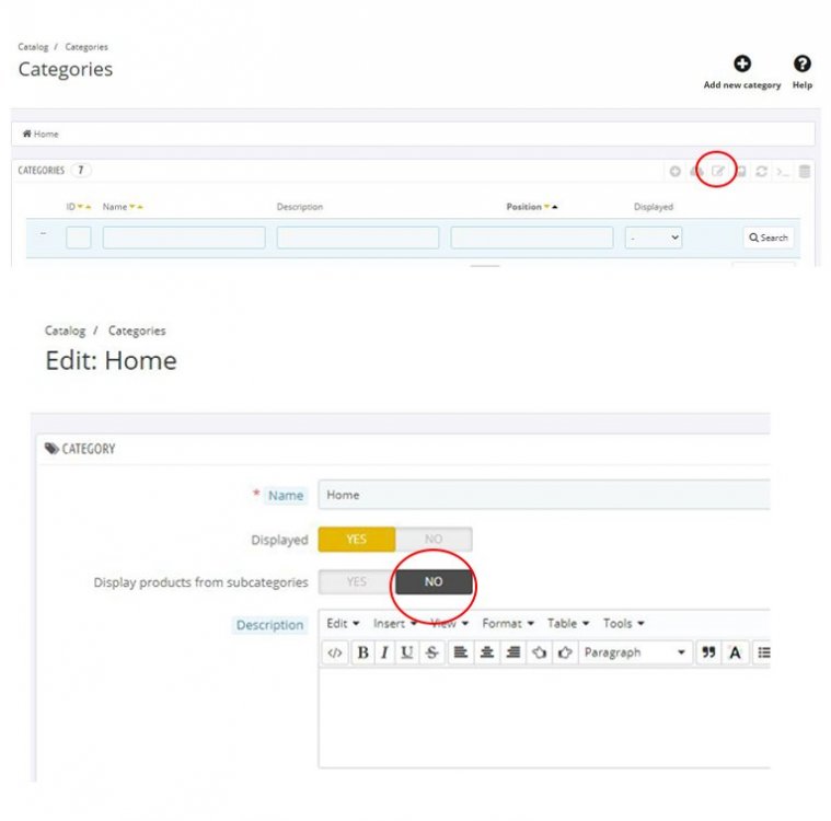

funnycamel Posted May 30, 2020 Author Share Posted May 30, 2020 I found the answer. There's a setting which was hard to find for the Home category and I needed to set it to "No" for "Display products from subcategories". I uploaded the image of both pages for anyone who is interested. First you need to click the little edit icon, then change the subcategories setting. So two things I learned today.. resetting the ntree and accessing the Home category settings. 1 Link to comment Share on other sites More sharing options...
