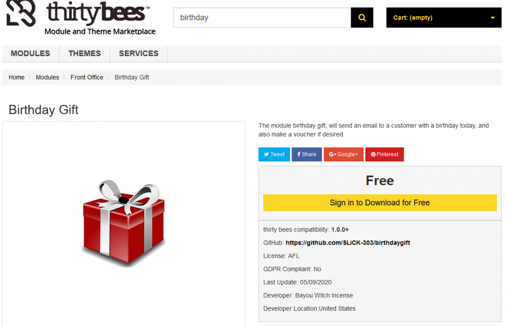

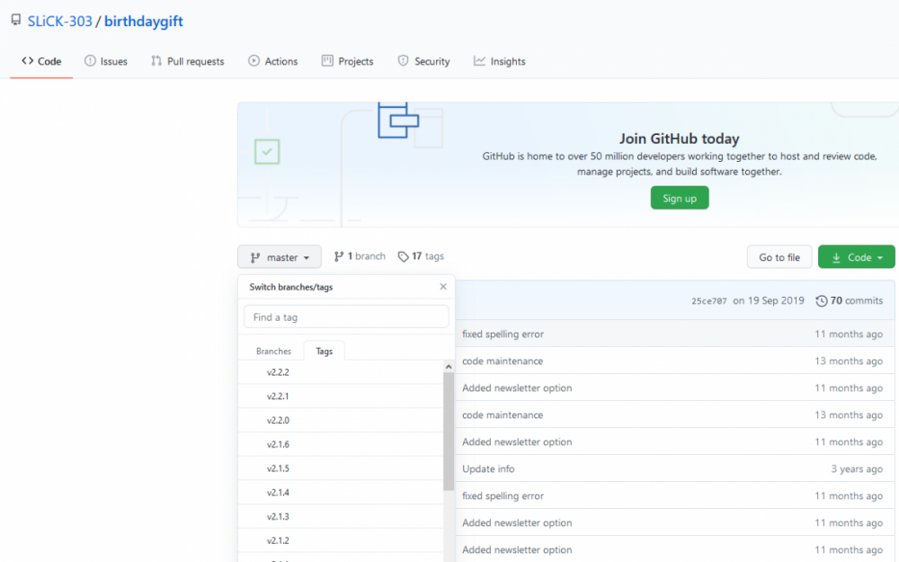

0 colorful-ant Posted August 23, 2020 Posted August 23, 2020 (edited) @WildToddMan i am not 100% sure. but at least 98% 😉 1. if you have the zip file from github it is normal. The master zips don't work like that. upload - install. always download the latest version from github. 2. if you downloaded the file from the TB shop, it was probably integrated incorrectly there by mistake. if option 1 applies, then it is normal from my point of view, I know this from prestahop. As I see the first picture (upload -> birthdaygift-master.zip), you have not logged into the TB shop, you just followed the link and downloaded the wrong file. To download the current version, register in the TB shop or switch from master to tag on github simple click master - switch to tags - change your liked version (most the latest) -> then download ........ and modul install works 😉 Edited August 23, 2020 by colorful-ant
0 WildToddMan Posted August 23, 2020 Author Posted August 23, 2020 I actually downloaded them all from GitHub. The link on TB Store did not work. So I right clicked on the GitHub link, and then downloaded that zip. I did not know about doing the tabs part though. Thanks!
0 colorful-ant Posted August 23, 2020 Posted August 23, 2020 If you are registered in the TB-Shop, the downloads in your customer account should normally work. Personally, I am not aware of any problems. Maybe try a different browser. When downloading from Github, the easiest way is to switch to tags to download the latest (current) version. The version should be visible in the zip file and not master. No matter whether here at TB or free modules from Prestashop that are compatible with TB.
0 datakick Posted August 24, 2020 Posted August 24, 2020 6 hours ago, colorful-ant said: When downloading from Github, the easiest way is to switch to tags to download the latest (current) version. The version should be visible in the zip file and not master. Actually, this should be the only way. The download link @WildToddMan used is to clone / download repository content. That's not necessarily the same as a ready-to-use module. Many modules must be *build* in order to have working product
