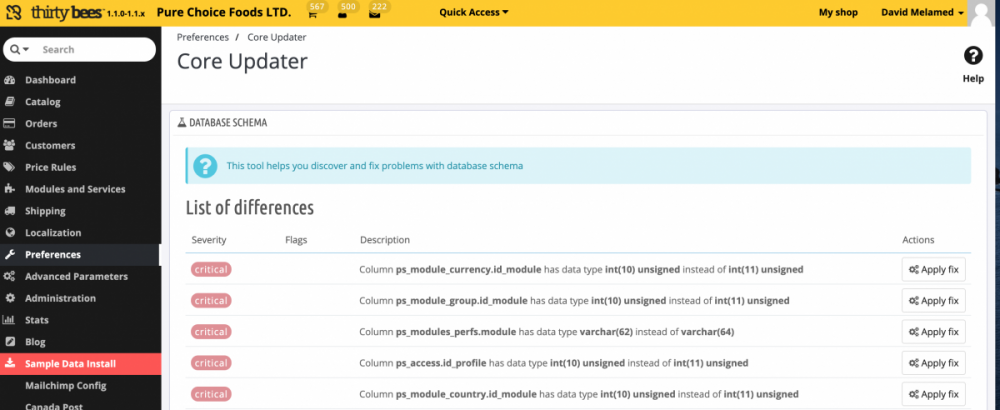

purechoice Posted September 5, 2020 Posted September 5, 2020 Under Database Schema I have hundreds of these. Do I have to hit apply fix and if so is there a way to do all or have to hit it hundreds of times?
0 the.rampage.rado Posted September 5, 2020 Posted September 5, 2020 Backup your DB and apply all of them. Nothing should change in your FO or BO. One (or few of them) may not get fixed with the button because of bug in the module which was identified and will be fixed in the next release. You can find my thread in the forum with the same question and the solution to this issue.
0 purechoice Posted September 5, 2020 Author Posted September 5, 2020 Do I have to do them 1 at a time? I did not see a select all and have it do it. Also, do I touch the ones that say dangerous?
0 the.rampage.rado Posted September 5, 2020 Posted September 5, 2020 Yes, I found out that if you make 2 instances in 2 windows side by side and start from different points in the list it's nearly twice faster. No automated way to apply all of them currently and probably there won't be one as some fixes rely on other to complete. 30 minutes - 1 hour of 'work' for 1000 fixes.

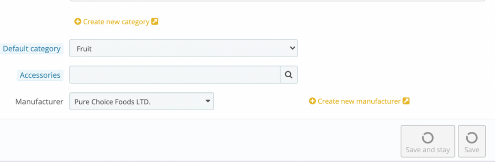

0 purechoice Posted September 5, 2020 Author Posted September 5, 2020 I deleted a couple of hundred and how I get a spinning on save and save and stay. Any ideas?
0 the.rampage.rado Posted September 5, 2020 Posted September 5, 2020 Very highly doubt this is related. As I advised you should have created backup of your DB. Now after the fixes - create backup of the after situation and restore your old one to check if this spinning button is fixed. If not you can restore the after situation and continue with the fixes while you search for solution to this issue.
0 datakick Posted September 6, 2020 Posted September 6, 2020 I don't think this is related. You should look to server log for any errors. Also check browser console network tab and look into ajax response content -- there are often some helpful information there. Also, don't forget to turn on debug mode in Advanced parameters > Performance.
