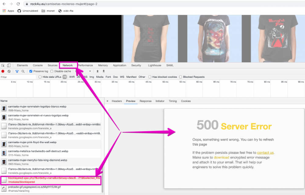

netamismb Posted September 29, 2020 Posted September 29, 2020 Have an issue with pagination only on one sub-category, ThirtyBees v1.1.0 theme Niara. For https://www.rock4u.eu/camisetas-rockeras-mujer when going to page 2, is appending a #/ instead of ? as everywhere else https://www.rock4u.eu/camisetas-rockeras-mujer#/page-2 Any idea what to do about it?
datakick Posted September 29, 2020 Posted September 29, 2020 Ajax call returns 500 error code. You should enable debug mode to see the root cause 1

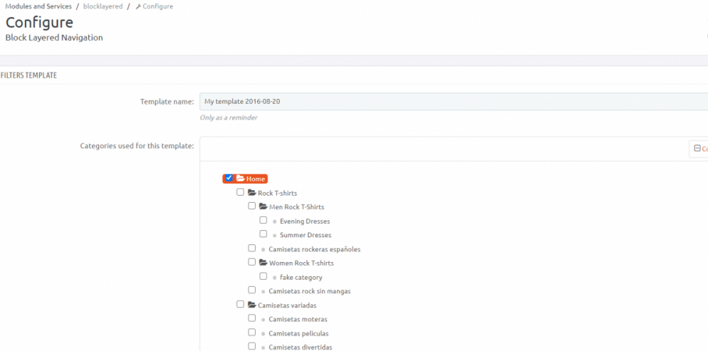

netamismb Posted September 29, 2020 Author Posted September 29, 2020 The issue was in Block layered configuration, apart from Home category was ticked also women Rock t-shirts category. Solved the issue unticked that subcategory like in printscreen attached
