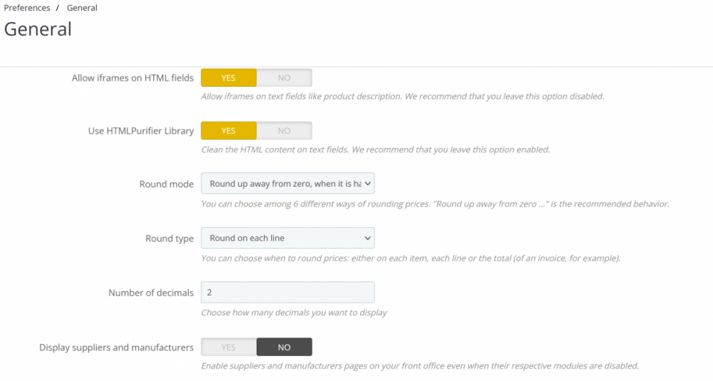

0 x97wehner Posted October 15, 2021 Posted October 15, 2021 Perhaps something in this screen is not set correctly. My settings are shown and seems to work fine. Otherwise, something with your tax calculations I would guess.

0 toplakd Posted October 26, 2021 Posted October 26, 2021 Make rounding on each item. As you use only 2 decimals you don't see the correct price for single item after tax is added. Rounding on each line calculates the 12x product price, with all decimals not only the 2 you see, and it then rounds the line total to 2 decimals.

0 purechoice Posted October 26, 2021 Author Posted October 26, 2021 Here is a picture of the options I have. Which one should I pick?
0 purechoice Posted October 26, 2021 Author Posted October 26, 2021 OK, I see the line below. I changed to each item and kept it on the recommended.
