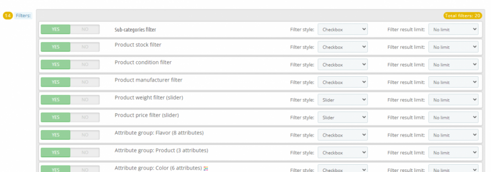

I am testing an almost clean installation. I am trying to change sorting of filters in the blocklayered module. Does that work for you? When saving, nothing happens here. Talking about this stuff:

There was problem put filters in order. Somehow this was messed up every time when you need to modify existing filter. So when filter items are ready then You need to put these in exact order before "Save" button. But next time when you need to edit this order is gone. I don't remember exactly but in my case I ended up sorting this in database. Table was ...layered_filter, if i remember correctly.
You can try rolling back to php 5.6 and see if it works. I have this issue on my modded version of the module from Warehouse theme.
After you make the changes in backoffice and save turn back php 7.3 or whichever version you use.
