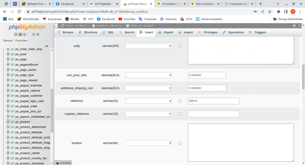

1. From phpmyadmin. Note the ref nr 85619 which is correct

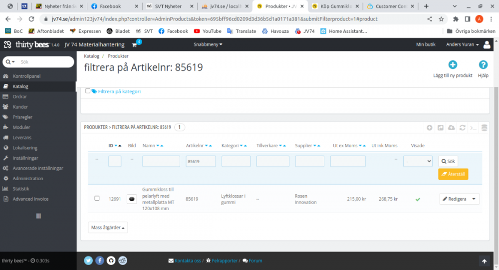

2. BO Ref or artikelnr 85619. correct

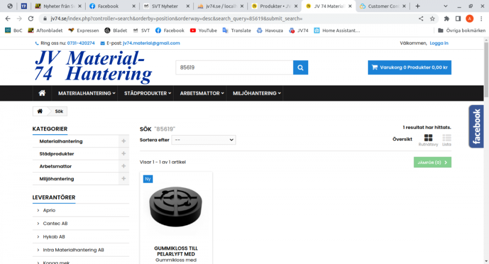

3 nSearch for 85619. Note the image and price. Its correct

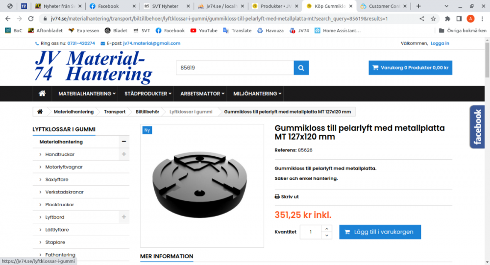

4. Detail for trhe product. Wrong refnumber (Artikelnr), wrong picture, wrong description.
All Info and picture is taken from the 85626.
I dont get it. Have you messed image 3 and 4? Then it would make more sense to me.
In general I would suspect a rewrite problem (same rewrite link) or just try to reindex the search.
I wrote the post and added the pics. But they came up in wrong order. But I think it's quite obvious which pic is which anyway. But it does not matter now, the rollback fixed it so we keep it there. We have tested everything. Taken away the post that always show up, it just change post. Maybe something went wrong with the update but for now we keep it as is. Perhaps I will try to update it again and see if the same thing happens but that means some downtime if it goes wrong so that has to wait.

In the example above the visible names of both products in the last 2 pictures are the same.
If you make a backup and update I'm sure this 'issue' will not be present as currently they are with different names in your shop (and because of that - different SEO urls). We don't know if you saw this and changed one of the products or not.
This is your 'issue' - SEO URLs sometimes could end up the same (product or categories) and the system picks the first in the db and redirects any later matches to it. Not a bug but a inconvinient feature and it's really easy to go around it.
