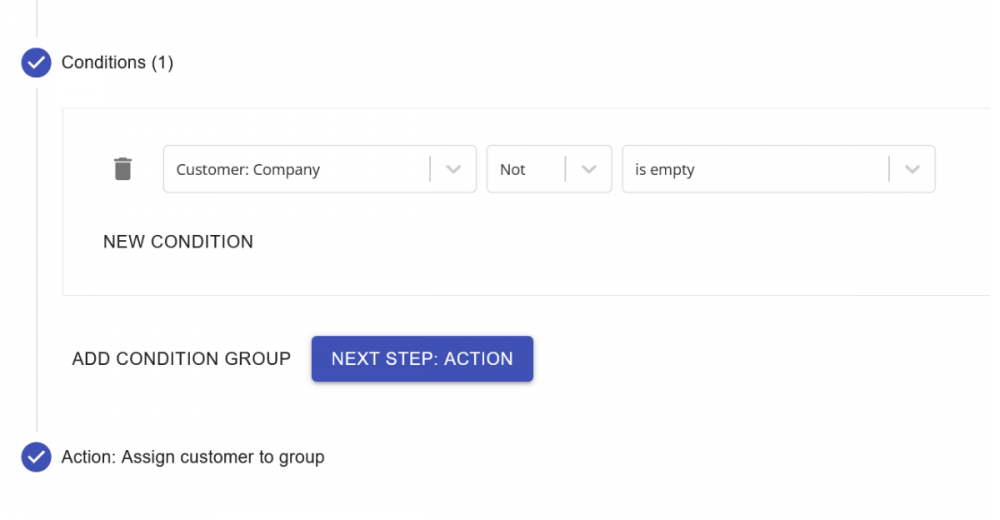

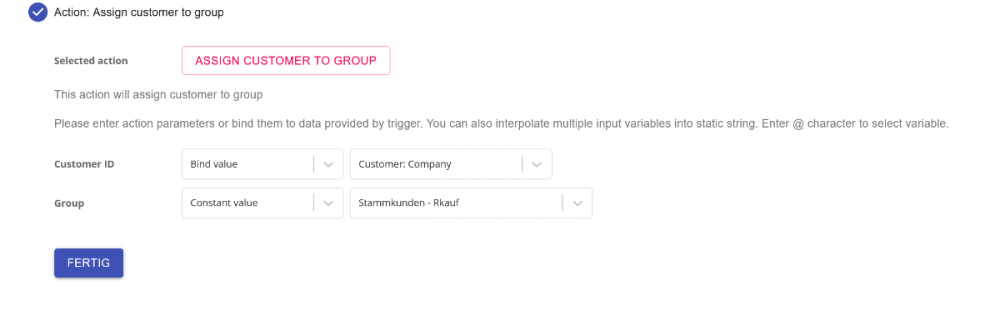

Pedalman Posted November 25, 2022 Share Posted November 25, 2022 Hello I like to make use of the great Conseq Module from Datakick. : At registration or address update, each time a customer fills out or updates the 'company' field the customer shall be assigned an additional 'group', e.g. 'vips'. Link to comment Share on other sites More sharing options...
0 datakick Posted November 25, 2022 Share Posted November 25, 2022 And what is the question? Link to comment Share on other sites More sharing options...
0 Pedalman Posted November 25, 2022 Author Share Posted November 25, 2022 Ehm, well I am pretty sure that it is not working. I tried it once... Question was, how I can accomplish that a customer is assigned a certain customer group when he/she fills out or updates the company field during checkout, address registration. Link to comment Share on other sites More sharing options...
0 datakick Posted November 25, 2022 Share Posted November 25, 2022 It works, I tested this recently. The problem will be in understanding what 'Company' field is -- this field is present only if you enable B2B functionality. It is NOT the company field that you specify in address. Link to comment Share on other sites More sharing options...
0 Pedalman Posted November 25, 2022 Author Share Posted November 25, 2022 (edited) Ok, weekend has started for me and my children are making noise as usual, but I doubt I would understand here which field is the right one even if it were Monday morning 🙂 I tried context:company but to no avail. Assuming that I can assign a condition (updated field in my case) and the cron is running each sec, which might be a no-go to do, I wonder if I can reach my goal. All I want is that only customers who fill out the field company are assigned to a customer group that is allowed to make use of a certain payment option. All others customers shall not see this payment option. Since I choose also Chex I wonder if such a 'real-time' change in payment options is possible. PS: I wish you a nice and refreshing weekend, too. Edited November 25, 2022 by Pedalman Link to comment Share on other sites More sharing options...
0 datakick Posted November 25, 2022 Share Posted November 25, 2022 I believe that you are talking about 'company' field stored inside Address. So you will have to base your rule on this record type -- when new address is created / existing address updated, do something. Trigger: Conditions: Action: Then you just have to figure out how to solve situation when customer have multiple addresses, one with company field set and other empty. 1 Link to comment Share on other sites More sharing options...
