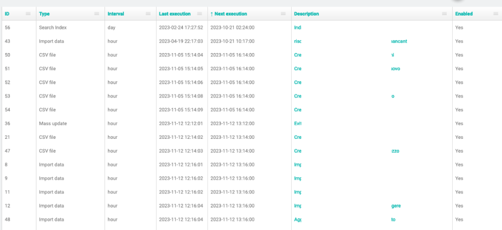

I have many schedules in @datakick manager module that stopped because "next schedule time" is in the past.
Hello,
Today I noticed that products was not imported/updated, and after checking my download and conversion to xml scripts I understand that the problem source was datakick manager's schedules not running. I can see that the issue started on November the 5th at 15:14, some schedules stopped to run the next hour (id 51 52 53 54 in the ).
I don't know why (maybe they failed or there was some server issue) but the module didn't update the next execution time and date so they are now in a limbo waiting for November the 5th 16:14 2023 that is not coming any soon. 🙂
Is it possibile to fix this behaviour?
Maybe checking for this kind of anomalies when cron start and re-arming them?
Pasting the image I now noticed two more schedules affected from this problem (id 56 and 43).
This issue was there even in the past and I always solved manually re-arming the affected schedules again (editing the time in the schedule and then restore the right time) but is starting to getting annoying as some schedules do background work and is difficult to notice if they stop to be scheduled.
