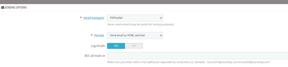

Email transport field is stuck on 'none' even after installing the phpmailer module
yaniv14 replied to chan's question in Technical help
after you installed phpmailer module did you configure the smtp for the module? -
After you installed the phpmailer module, did you selected it as email transport? -
