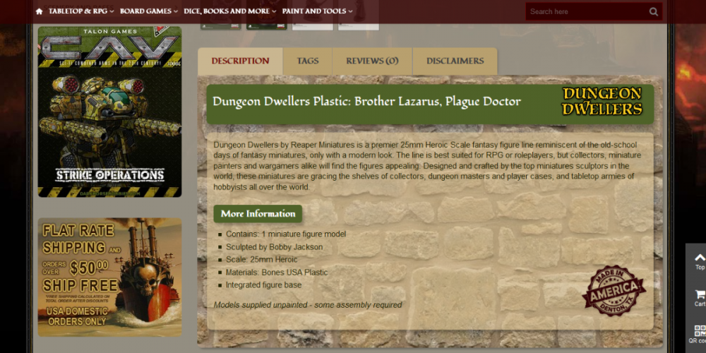

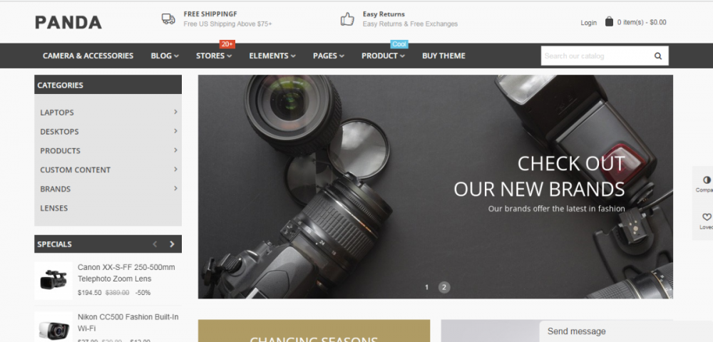

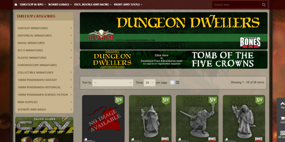

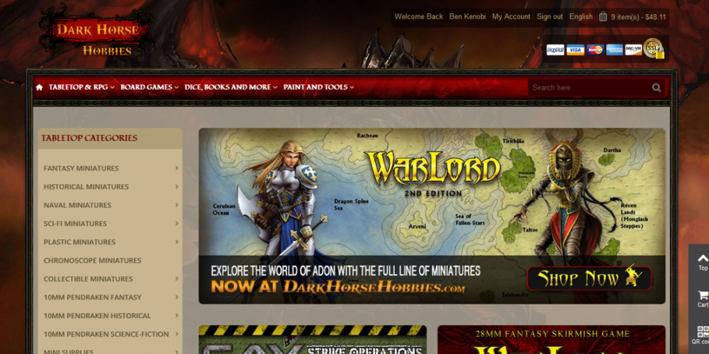

    Thank you for that information - very helpful. I do understand that the theme author can change the rules - part of the painful issue that has caused me to abandon panda for use with this new website. Besides various other issues, they changed the specificity on a large number of declarations breaking the custom css that gives my other site it's very unique appearance - 1800 lines of css morph the site from a bland out of the box default looking theme into what I ended up with. [screenshots attached] (Face it all of Panda's themes were more or less black and white variations of the original - but with lots of extra modules and the custom css and js fields in their editor - the theme worked and it worked well.) I praised them for quite some time for having a theme tool that allowed me to create such a site with almost no core code customization - but when I hit 1800 lines - because they stored the css code in the configuration table... it broke. That forced me to utilize the technique above moving that code into a custom.css file and loading it for proximity override. It's been through 2 upgrads of the theme and all was well until I attempted a migration from PS 1.6 to TB 1.3.0 with that site - boom! doesn't work... after a month - I'm done - I'll find another solution. And this is where your specificity COULD have helped, but they changed the selectors substantially so specificity would not have overcome that issue. I did not however give up on Thirty Bees, and because of the PHP version issues the hobby site is now facing - I chose to select TB for this new site rather than deal with Prestashop's stupidity in the 1.7 codebase. But I digress... I actually have my custom css working now using an override and I'm happy with that result. I may look into option 2 for a more flexible solution in the future - maybe - probably not though since option 3 does exactly what I was after. Screenshots of the other site created with Panda (Demo 7 theme was the style I started with): Listing Page: Product Page (above the fold): Product page (below the fold): The site gets a decent amount of traffic (server logs indicate 4.6 million hits this year with nearly 750k pages served). This is what that Demo 7 theme looks like out of the box ... Every page in the site has been customized with that proximity loaded custom css stylesheet... and if it weren't for the php issue with PS1.6 - I wouldn't even be considering making any migrations with that site. Hopefully this conversation can give others some inspiration in developing or customizing their themes. I'll come back and post what I've done with the community-default-theme if anyone is interested. Thanks again for providing the information, it should help others in the future.

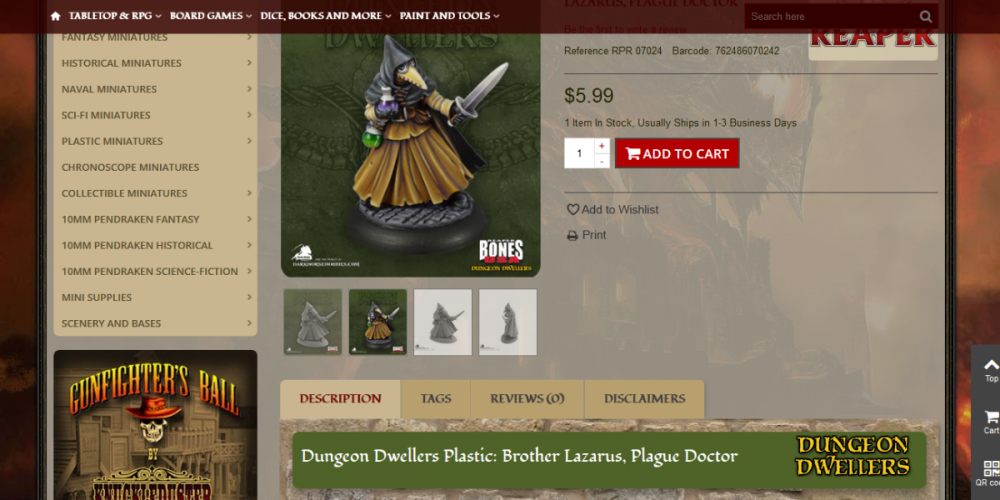

  2. Hello, I'm trying to move the wishlist button on the product page but can't seem to find where to hook it to move it next to the print button. I think transplanting it to $HOOK_EXTRA_LEFT would do the trick but can't seem to find a location that uses that hook for the wishlist block. I've created a new theme (mostly just a copy at this point) from community-theme-default if that makes any difference. Thanks!
