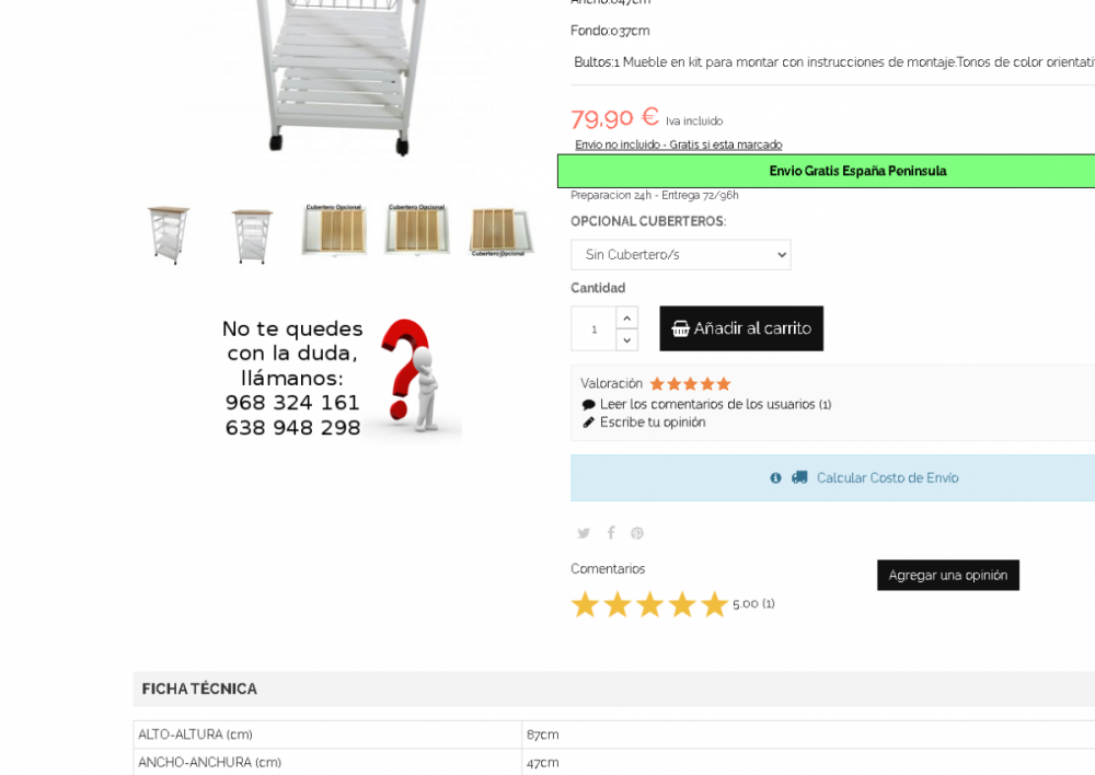

I have finally succeeded, I attach an image. In case anyone is interested, the position is line 234 of product.tpl of version 1.2 thirtybees.

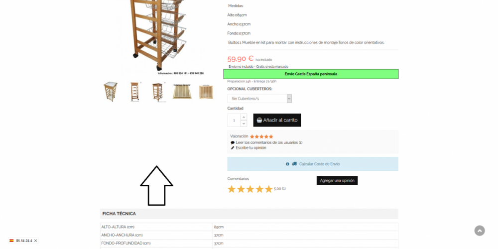

Thank you very much for anwser, i want to add new hook in this place for publicity or images in htmlbox module by Vekia or html code
Yes, this is my problem because i try in to put some code for a new hook in some places but i don't get the rigt place
Hello, I would like to add images or text after the product images, but I've been going around for a while and I can't do it, someone can help me, please Thank you very much for your time
