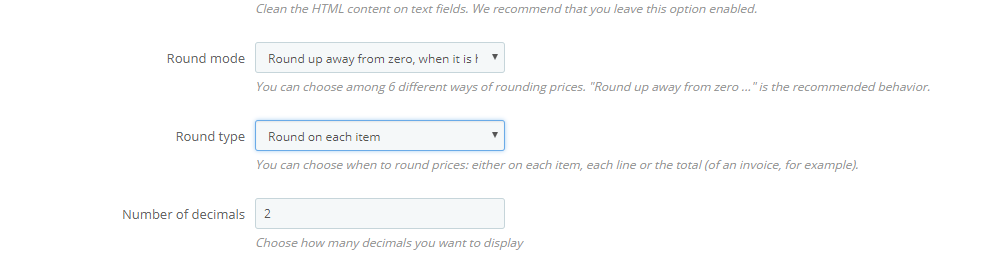

I can't seem to get rounding correct in the cart, very frustrating. As you can see in my screen shot my first line item should = $81.54 ($27.18 x 3) and then the 2 lines together should = $99.53. I can't and do not want to round in this way. The round should not go past 2 decimal places. This would be not different than buying clothing in a brick-and-mortar retail store, they would not round in this way. I have tried 4 decimal places in preferences-->General as well as every option under 'Round mode.' I have also tried 'Round on each item' and 'Round on each line'. 0_1531856792572_shopping cart rounding issue.PNG0_1531856893547_current setting for rounding.PNG

@oliiiix Have you tried to set your rounding rule to "per article" instead of "per line"? If it is set to per line, it will round each position after adding the amounts per article, that is useful for shops selling, for example, ropes in feet or something. If you only set articles by piece instead of per foot or per lbs, then you should set the rounding rule to "per article".

Rounding to 10 Rappen needs no code changes. One can set the number of decimals in general preferences, set this to 1 and turn auto-formatting of the currency off.
Only caveat then: display after the decimal is limited to one digit then as well. As the second digit is always zero, it can get hardcoded in the theme.
