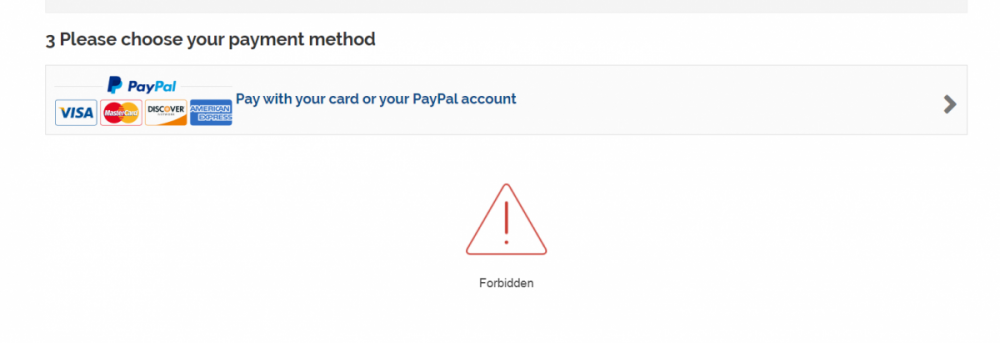

We are in the UK, and we have website pro for Paypal. This allows customer to pay by their paypal account or by card, and the payment page is clearly obvious

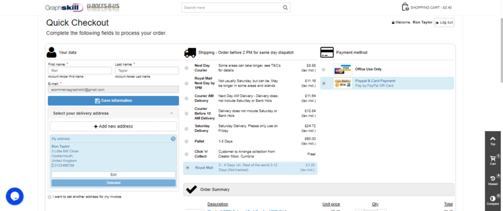

Currently using the PayPal bodue from PS. Configuration is:
Customer see this:
In the 30bees module we just get a "forbidden" message. If needed I will install again tonight and show the screen, but I don't like to play too much while the site is active.

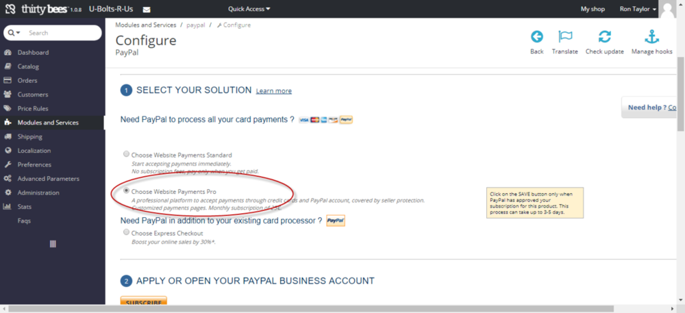

1) It would be great if the 30bees module had a different name so that both could be installed a the same time. Currently I have to uninstall the PS module to test the 30bees module (we don't have a testbed)
2) In the 30bees module is the "pro" option the same as the PS module? I wondered if in 30bees the "Pro" option is actaully a European version and not allowed on UK sites?

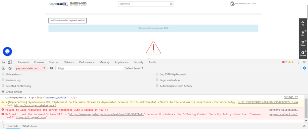

If you want me to look at it at some point I can, its a content policy issue. I just don't have access to our pp account right now where I can create creds to test it out.

1) "pro" in the 30bees module is the same as Website Pro in the UK so I should be able to use it?

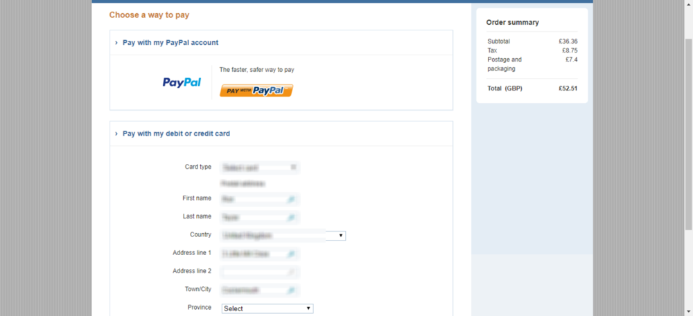

2) Using the 30bees module I should be able to get a screen looking exactly like this? (e.e PayPal account AND card details on same page - and expanded like this)

That screen there looks like the standard paypal payments screen, not the pro screen. But honestly I am not 100% sure, because they label platforms different in different countries causing a lot of confusion.
It is not the standard PayPal screen. On the standard screen they try to "hide" the pay by card system and encourage you to sign up for an account. Most of our clients are businesses and I need the card payment option to be very obvious and easy

The buyer can still login or checkout however, the Forbidden warning at the bottom is distracting. Maybe, the band-aid solution is to hide it but I don't know if its doable.
On 3/4/2019 at 5:07 AM, lesley said:
Its not the best solution, but try adding this line to the top of your htaccess file. T
Header set Access-Control-Allow-Origin "*"
It seem the Website Payments Plus causing the error message to appear. When I disabled it the forbidden error at the bottom is gone.
Correct. We switched back to standard and all is ok. Just means customers can’t add card details directly on the website, but on reflection because of PCI compliance was probably better for us anyway.
