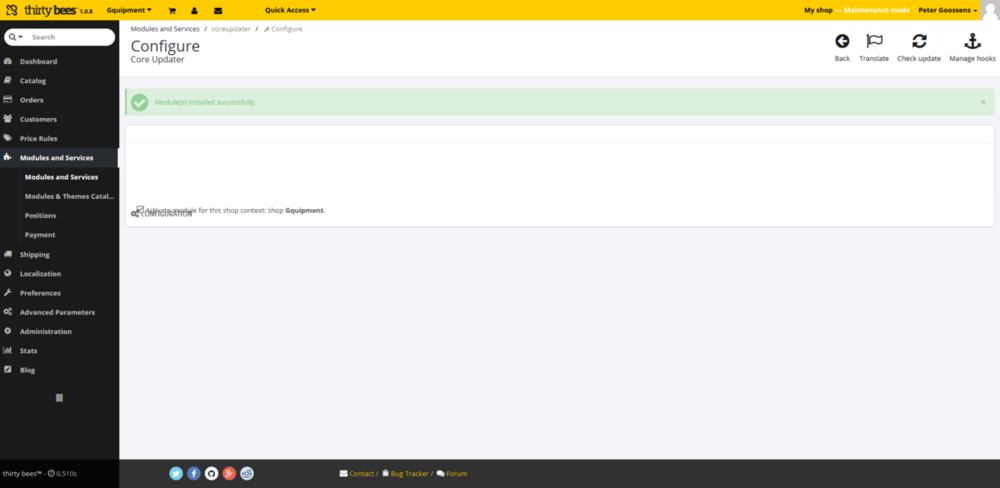

15 hours ago, Dolfijn said:
If I try to configure the core updater I get an empty screen. I guess that is not quite right..?
While there isn't much to see on Core Updater's configuration page, this doesn't look right either. There should be a message hinting to the new menu item.
Filed here, hints on how to reproduce this always welcome!
https://github.com/thirtybees/coreupdater/issues/4
I don't now how to reproduce this except that it is happening at my site (If you have additional question, please feel free). I can only tell that I started from PS 1.6.24, migrated to TB, run the updater, installed the blog modules and then tried to run the core updater. I'm running a multishop indeed.
