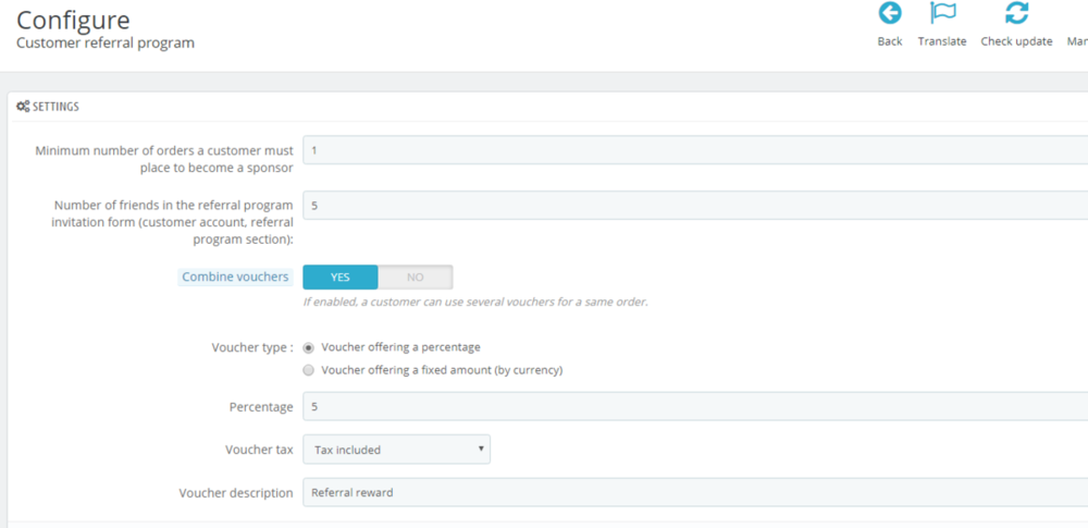

CoffeeGuy Posted April 4, 2020 Posted April 4, 2020 Sorry to reply to an old thread. I've just installed this module, and configured it, but it does not show me a URL or how to access it. Any assistance?
