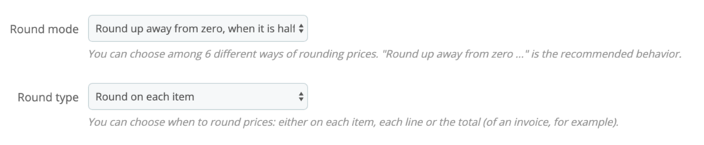

Factor Posted June 14, 2019 Posted June 14, 2019 Ok let me see here. Is your rounding set Preferences General to remove tax encl Go to countries . find the countries you sell to.. at bottom save . next country repeat... Lets start there... 1
AndyC Posted June 14, 2019 Author Posted June 14, 2019 (edited) @Factor ... Thank you , was round type causing that issue on this occasion . Everything adds correctly. Now I added another cost from the Product Fields manager module But still end up with a weird total.. It was my test total of £23.48 the item I am buying is £23.48 so surely it should be free ... It seems to be subtracting the shipping when it shouldn't .. I've even made it free shipping Edited June 14, 2019 by AndyC
