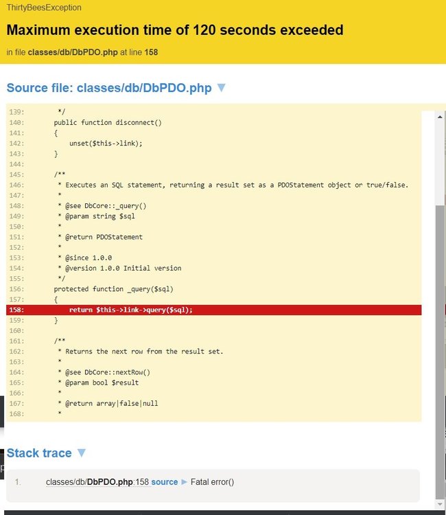

musicmaster Posted November 11, 2019 Posted November 11, 2019 (edited) I am testing the bleeding edge under PHP 7.3. I get some serious issues that happen only under Windows: - I get irregularly the warning Warning on line 66 of /modules/cheque/cheque.php [2] count: Parameter must be an array or an object that implements Countable in many different pages. The module is present but not installed. Line 66 says: if (!count(Currency::checkPaymentCurrencies($this->id))) and I have no idea what could go wrong there. - the second problem is a first class showstopper: I cannot submit an order. I test with bankwire. When I press the final button to confirm the order/payment I get a timeout. The error screen isn't helpful: it only lists the database module. Edited November 11, 2019 by musicmaster

musicmaster Posted November 11, 2019 Author Posted November 11, 2019 About the other error: the order that cannot be submitted. Here is how a timeout looks: I put some code in it to see what queries are processed. The first 152 queries look to be normal processing. But then it gets in an endless loop sending the following two queries again and again: SELECT `AUTO_INCREMENT` FROM INFORMATION_SCHEMA.TABLES WHERE TABLE_SCHEMA = 'snoeptb9' AND TABLE_NAME = 'ps_orders' LIMIT 1 SELECT * FROM `ps_orders` a0 WHERE (a0.`reference` = '0')
datakick Posted November 12, 2019 Posted November 12, 2019 6 hours ago, musicmaster said: I put some code in it to see what queries are processed. The first 152 queries look to be normal processing. But then it gets in an endless loop sending the following two queries again and again: SELECT `AUTO_INCREMENT` FROM INFORMATION_SCHEMA.TABLES WHERE TABLE_SCHEMA = 'snoeptb9' AND TABLE_NAME = 'ps_orders' LIMIT 1 SELECT * FROM `ps_orders` a0 WHERE (a0.`reference` = '0') There is no place in the core that queries information schema in this way. This must come from some module. My guess would be some module that generates custom order reference numbers, and it probably can't handle situation when there are no orders in the database yet... 1
musicmaster Posted November 12, 2019 Author Posted November 12, 2019 4 hours ago, datakick said: My guess would be some module that generates custom order reference numbers, and it probably can't handle situation when there are no orders in the database yet... Quite a good guess. After some search I found that the origin of the first of the two queries was the Order.php override file from Greenmouse's gmnumeric. However, the real cause appeared to be a faulty import. There were orders in the database but the auto-increase index was zero.
