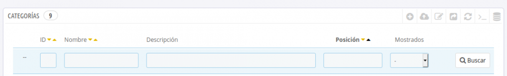

I just discovered that on BO categories page i can't choose the type of category to create root category or child category ...
this is my category page:
1356758910_Screenshot_2020-12-18CategorieMUDRASHOP.png.7bcc41a754c66bde2a98c16d7da36ec0.png
and this is how it should be:
671296091_Screenshot_2020-12-18CategoriesMsingrosso.png.97fb09d7a6e5ca6e6d5ac33b1720070c.png
i can create, edit and manage the categories, but i can't make any parent category....
Can anybody point me in the direction to understand where to check to find the reason of this problem?
Thank you in advance for your suggestion ....
