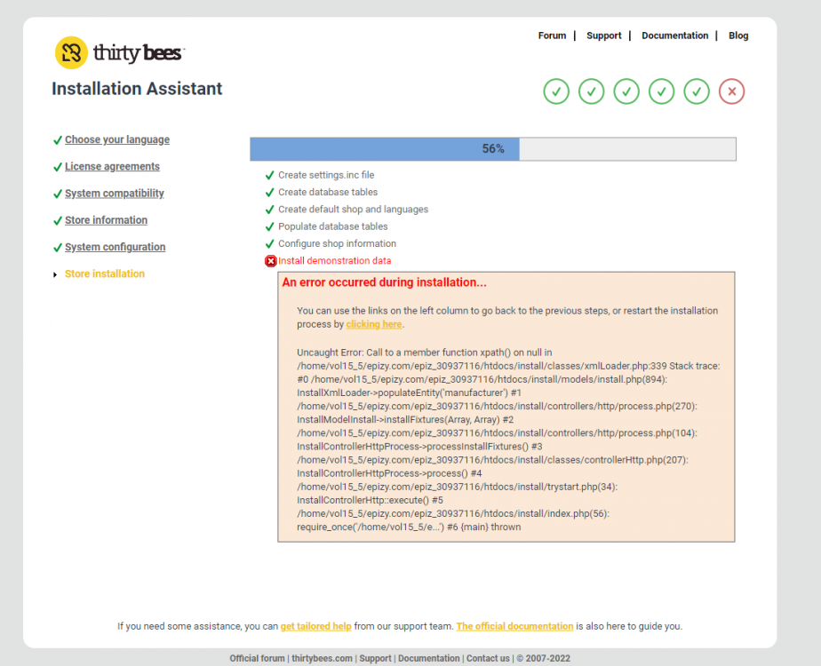

Hello, I got this error trying to install thirtybees, I contacted my hosting provider and this is what they answered to me:

As far as I can tell, it’s trying to load XML data with manufacturer information. But apparently, some of the demo data is invalid, or there is a code error in trying to load it.
I think you may have more luck with this question on the thirty bees forum. I’m not sure if this is a hosting issue or not, but the issue happens so deeply within thirty bees that I can’t tell.

3 hours ago, datakick said:
well thats strange. The only reason for this behavior that comes to mind is missing php xml extension
Is there anyway to confirm? What would be the solution to that if that was the case?

PHP 7.4
Create file phpinfo.php in the root directory of your installation with following content:
<?php
phpinfo();
And then open www.yourdomain.com/phpinfo.php. It wil tell you what extensions are used

I can't find any extensions section in what it's showing me.
Also, now when I try to access my domain I get this 500 error and it gave me a file to download
exception_20222294918.txt
