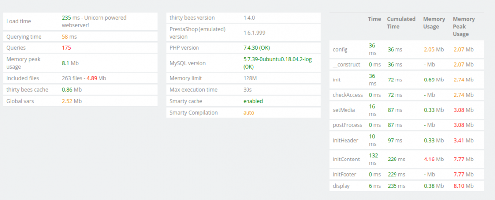

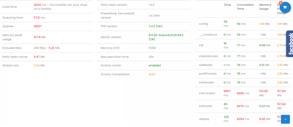

Havouza Posted August 9, 2022 Author Posted August 9, 2022 @datakick To compare the other server that is on the same vps and all else is the same

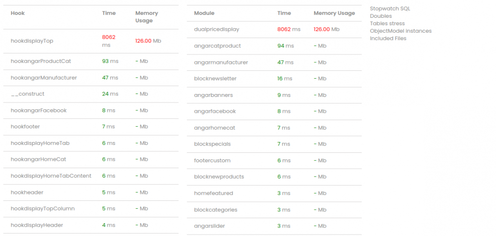

datakick Posted August 9, 2022 Posted August 9, 2022 There you go. Module dualpricedisplay is a culprit
Havouza Posted August 9, 2022 Author Posted August 9, 2022 the strange thing is that it is on both shops. But at least somewhere to start Loadtime is still 1136 ms
Havouza Posted August 9, 2022 Author Posted August 9, 2022 ok problem solved for now. Thousand thanks to @datakick for your patience
