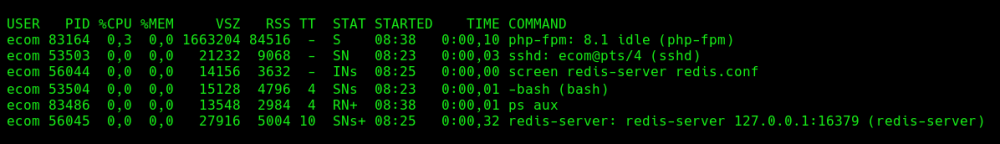

e-com Posted August 12, 2022 Posted August 12, 2022 Redis cache works fine in TB. Also, I suggest checking your Redis configuration on server. 1
Havouza Posted August 12, 2022 Author Posted August 12, 2022 @e-com Its interesting. Again now, I followed all the installation steps, all config steps, tested without and with authentication using ssh. All works. Fill it in in the form on TB, press Test and its read. I have no clue what to do next. I assume I dont have to open that port in the firewall
Havouza Posted August 12, 2022 Author Posted August 12, 2022 @e-com Do I need a php package installed also? php-redis
e-com Posted August 12, 2022 Posted August 12, 2022 3 hours ago, Havouza said: @e-com Do I need a php package installed also? php-redis Yes, for example for PHP 8.1 on debian: https://packages.debian.org/en/sid/php8.1-redis And phpinfo();
Havouza Posted August 12, 2022 Author Posted August 12, 2022 I use ubuntu 20.04. it has both php 7.4 and 8.1. We use 7.4 and have installed the redis package but for some reason it dont show up. Its already in 8.1 but too many modules does not work with it so thats no deal. Well we have to see.
Havouza Posted August 12, 2022 Author Posted August 12, 2022 Finally. There was a special package php7.4-redis. Now it works. Thanks
