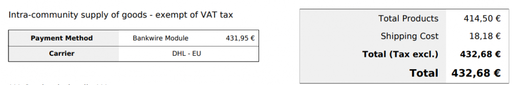

30knees Posted February 8, 2023 Posted February 8, 2023 The reason I'm asking is because an invoice I opened shows two different totals, see below. I don't know where the price discrepancy would come from. I edited the shipping price from 20 to 18.18, but that's not the difference between the two totals.
1 datakick Posted February 9, 2023 Posted February 9, 2023 On 2/9/2023 at 12:49 PM, e-com said: The ability to generate a PDF invoice has nothing to do with whether the order is paid or not. In configuration of order statuses we can set that for all statuses it is possible to generate a PDF invoice. However, module you are using is bugged and incorrectly updates data of the PREFIX_order_payment table. And now you have inconsistent data in database tables. Expand Actually, when you generate invoice, and no payments are recorded yet, system will create new payment record. https://github.com/thirtybees/thirtybees/blob/8b522e19ccaadd1ba6570d5d853628bd7f471ed8/classes/order/Order.php#L1590 There is a comment in code: Since an invoice always requires an existing order payment, we are going to add one Looks like thirty bees does not support unpaid invoices??? Anyway, if you modify the order after the payment is recorded, you should record additional payment (possibly negative) All payments will be displayed on invoice, making it match 1
0 30knees Posted February 8, 2023 Author Posted February 8, 2023 I discovered that when one generates an invoice the system thinks the order was paid (even if you don't change the order state to a state that is paid but leave it unpaid). This is the order total that shows up above as 431,95. I edited the order I had generated the first invoice because the customer requested some changes. I then deleted the old invoice and generated a new one. The 431,95 was taken from the old invoice.
0 e-com Posted February 8, 2023 Posted February 8, 2023 By default, it is not possible to change delivery cost for any of the order statuses. It looks like you have some module that enables this. And in this module you should look for errors of incorrect update of order value.
0 30knees Posted February 9, 2023 Author Posted February 9, 2023 (edited) Correct, I have a module to edit orders. 🙂 But I guess that's still independent of the issue that when one generates an invoice the system thinks the order was paid (even if you don't change the order state to a state that is paid but leave it unpaid). Edited February 9, 2023 by 30knees
0 e-com Posted February 9, 2023 Posted February 9, 2023 The ability to generate a PDF invoice has nothing to do with whether the order is paid or not. In configuration of order statuses we can set that for all statuses it is possible to generate a PDF invoice. However, module you are using is bugged and incorrectly updates data of the PREFIX_order_payment table. And now you have inconsistent data in database tables.
0 30knees Posted February 9, 2023 Author Posted February 9, 2023 Does that make sense, no invoice without a payment? It depends on your type of accounting but it feels like it shouldn't be decided by the shop.
0 datakick Posted February 10, 2023 Posted February 10, 2023 On 2/9/2023 at 4:51 PM, 30knees said: Does that make sense, no invoice without a payment? It depends on your type of accounting but it feels like it shouldn't be decided by the shop. Expand It make sense in B2B mode. Not so much in B2C
0 wakabayashi Posted February 10, 2023 Posted February 10, 2023 On 2/9/2023 at 1:03 PM, datakick said: Looks like thirty bees does not support unpaid invoices??? Expand Yeah there are some issues with it. I remember, that I have at least outcommented the following: if ($orderStatus->logable && (string) $cartTotalPaid !== (string) $amountPaid) { $idOrderState = Configuration::get('PS_OS_ERROR'); } in validateOrder() of PaymentModule.php But surely that is not a clean solution. In general this problem is also a bit related to a messy order status handling. (These kind of problems are also known by our loved brother: https://github.com/PrestaShop/PrestaShop/discussions/31038) 1
