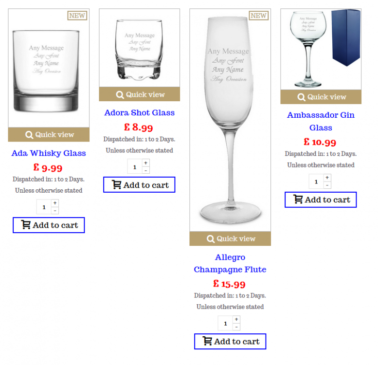

AndyC Posted May 14, 2023 Posted May 14, 2023 (edited) Hi All Am still on Version 1.6 and php 7.4 & Panda I have been lucky enough to have been trouble free for quite some time now. But today my images for some reason have gone completely haywire as I thought it would be a good idea to regenerate my images as I haven't done it in a long while.. My first thought which seemed to work was to delete and re-add the images that were huge via admin products and that did seem to work but there are just to many.. I've regenerated 3 times and it hasn't helped My next idea was to try a restore but it hasn't work either... what could the issue be please as as you can see from the image some of them are huge does matter where it can be home page category or product. They have been fine up until today ... thank you Edited May 14, 2023 by AndyC
e-com Posted May 15, 2023 Posted May 15, 2023 In Preferences -> Images "Generate images based on one side of the source image" you probably have it set to Height. Change it to Automatic.

AndyC Posted May 15, 2023 Author Posted May 15, 2023 Thanks ... It was set to long.. But has been that way for a long time.. I did set to short but used another module to rebuild images which obviously didn't work. I've tried again today with automatic and seems to have worked this time.. My biggest problem was the time it was taking, over 3 hours as have quite a few images. But everything is back to normal. So thank you 1
