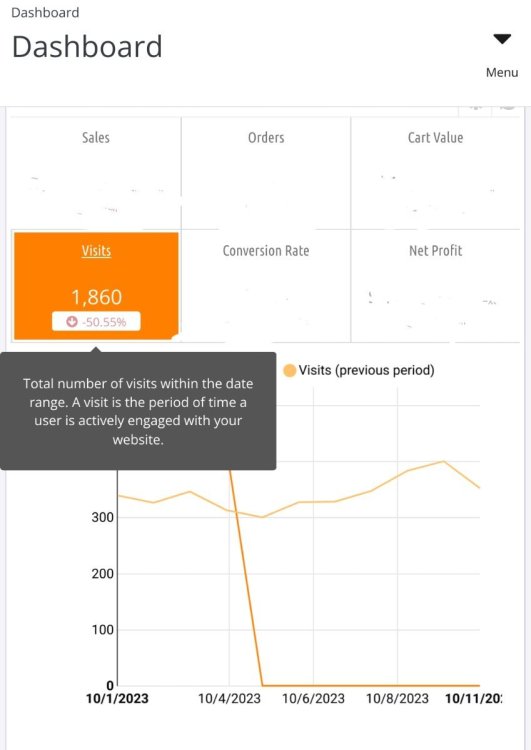

x97wehner Posted October 11, 2023 Posted October 11, 2023 Hoping someone can help me here. The visits on my dashboard stopped counting on the 5th as shown in the attached image. I can't figure out what would have caused this? Google analytics is still working and counting my visitors and so are the rest of the dash statistics, just not TB. I checked the stats report too and it seems to show TB counting correctly as well. Any idea what could be the cause and how to resolve? Is it a dashboard bug?

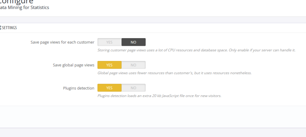

datakick Posted October 11, 2023 Posted October 11, 2023 Do you have statsdata module installed and enabled?
x97wehner Posted October 11, 2023 Author Posted October 11, 2023 6 minutes ago, datakick said: Do you have statsdata module installed and enabled? Yes
x97wehner Posted October 11, 2023 Author Posted October 11, 2023 9 minutes ago, datakick said: Do you have statsdata module installed and enabled? As you can see, it's still counting in the db. Just not showing on the dashboard it seems

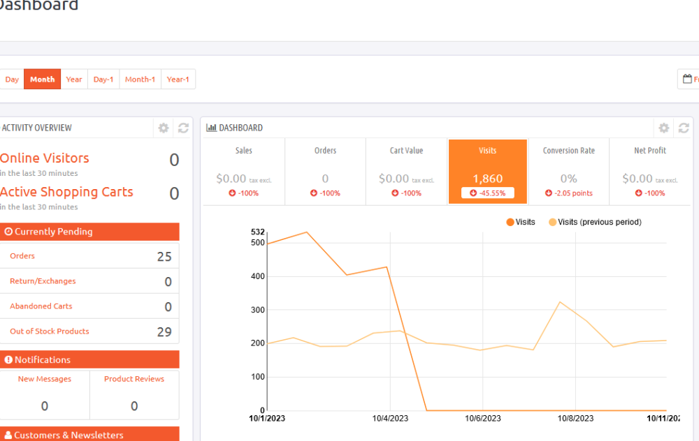

x97wehner Posted October 11, 2023 Author Posted October 11, 2023 Okay, something very strange is happening. I just checked my development site and I see the exact same result in the metric listed for visits as shown below. This number is impossible since the development site is not public facing and has a completely different database and gets no visitors but me. Where is this visit metric supposed to be sourcing from? It has to be an error in the code. @datakick
x97wehner Posted October 11, 2023 Author Posted October 11, 2023 (edited) 14 minutes ago, datakick said: are you using gapi module? I am, and since you mentioned it, I've now disabled and the correct number displays in the dash. Edited October 11, 2023 by x97wehner
datakick Posted October 11, 2023 Posted October 11, 2023 in that case dashboard shows data fetched from google analytics.
x97wehner Posted October 11, 2023 Author Posted October 11, 2023 1 minute ago, datakick said: in that case dashboard shows data fetched from google analytics. Interesting. Thanks. I checked GA and the drop in tracking aligns with their deprecation of UA tagged properties and, at least my configuration, isn't connecting GA4 to TB. I'll investigate if it's my configuration error or if a revision is needed for the module.
