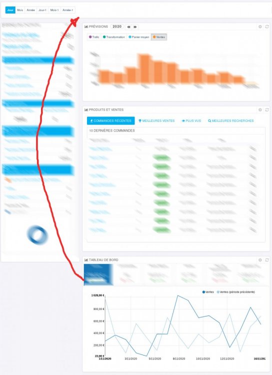

Hello, How I can reorder the main dashboard panel in controller=AdminDashboard ? I would have the main dashboard panel at the top of the page. I Don't find the hook to order position?

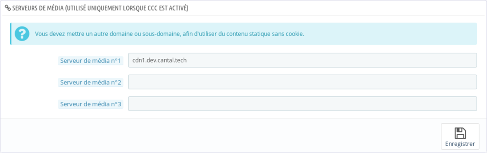

Hello On the latest update on 1.1.X branch When wepb + cdn are enabled webp static ressource are on cdn and works great jpg are redirect with 302 on homepage?? example: curl -i https://cdn1.dev.cantal.tech/20305-futurheli-2019_thickbox_default/kyosho-dameuse-blizzard-fr-couleur-2015-radio.webp HTTP/2 200 server: nginx/1.14.0 (Ubuntu) date: Wed, 20 Nov 2019 09:57:58 GMT content-length: 41274 last-modified: Mon, 04 Nov 2019 23:01:08 GMT expires: Thu, 31 Dec 2037 23:55:55 GMT cache-control: max-age=315360000 x-cache-status: MISS cache-control: must-revalidate, proxy-revalidate access-control-allow-origin: https://futurheli.dev.cantal.tech curl -i https://cdn1.dev.cantal.tech/20305-futurheli-2019_thickbox_default/kyosho-dameuse-blizzard-fr-couleur-2015-radio.jpg HTTP/2 301 server: nginx/1.14.0 (Ubuntu) date: Wed, 20 Nov 2019 09:58:07 GMT content-type: text/html; charset=utf-8 content-length: 0 location: https://futurheli.dev.cantal.tech/ expires: Thu, 31 Dec 2037 23:55:55 GMT cache-control: max-age=315360000 x-cache-status: MISS cache-control: must-revalidate, proxy-revalidate access-control-allow-origin: https://futurheli.dev.cantal.tech When CDN Disable workfine (jpg are correcly served) When Url rewrite Disable work fine too PS: I use a reverse ngins proxy but backend is a classic apache2.4 server. for me it's a rewrite apache2 directive who are not correctly updated -
