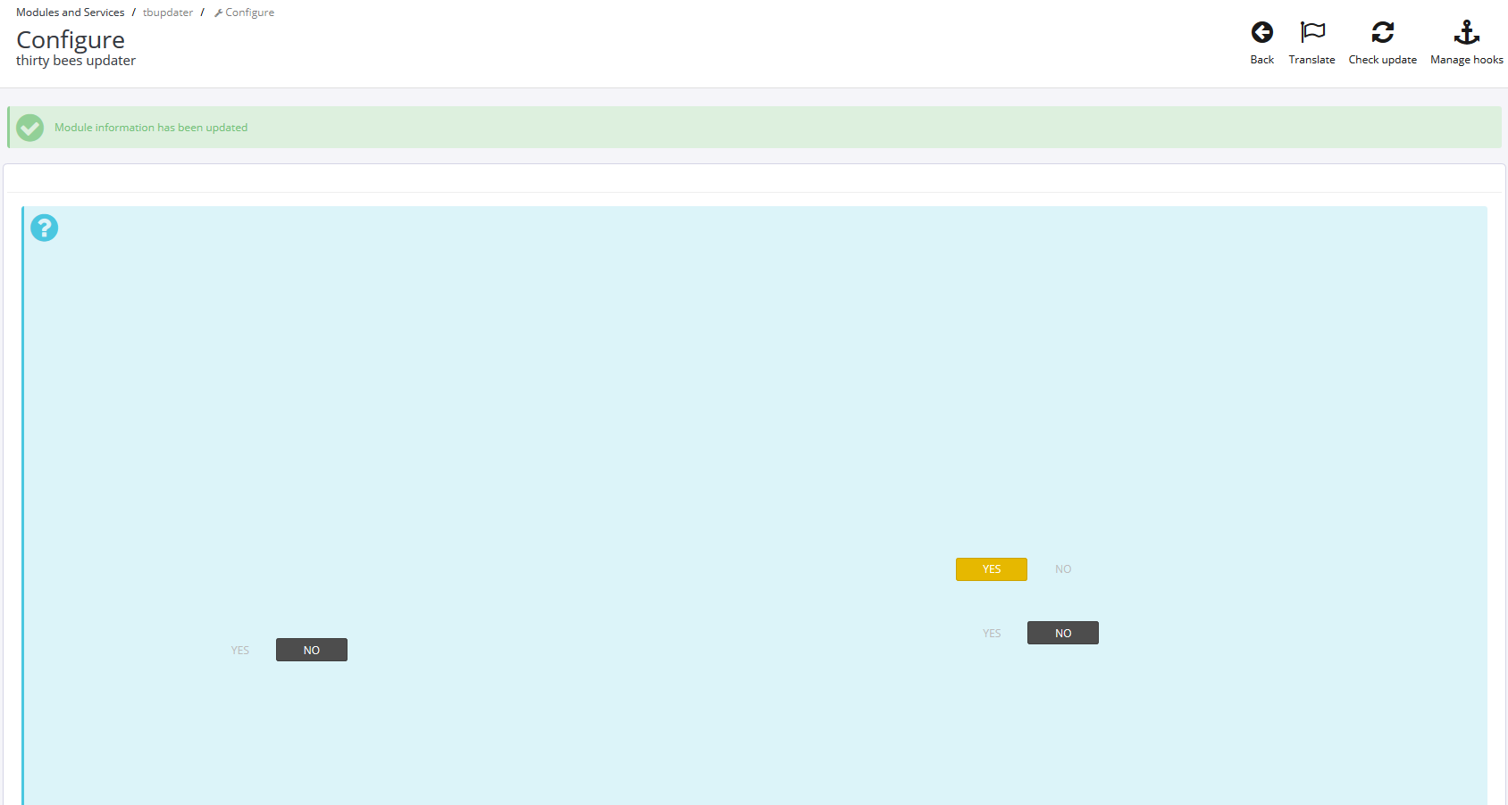

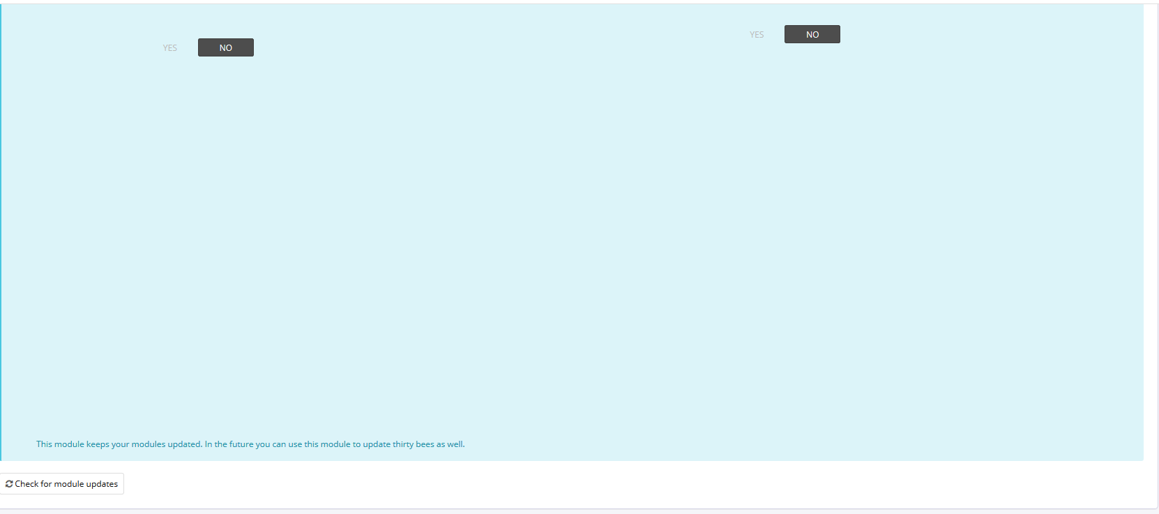

  • Fixed graphics glitches for window sizes between ~900 and ~1200 pixels (bootstrap md and lg).
  • Should work better on Windows now, thanks to @musicmaster .

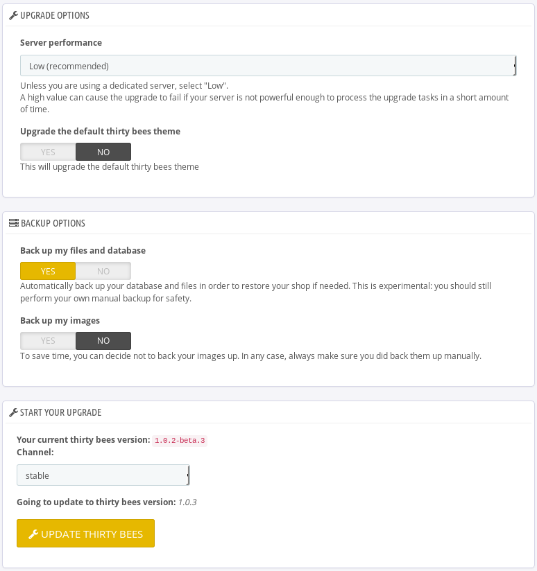

  • Backups should actually work now, also thanks to @musicmaster . No longer these 12 million files to backup messages (which actually started over in case one waited that long). It should show the actual number of files now and finish as all of them are backed up.
  • Panels on the module page should now be in a more logical order. Update options above the "Update" button, for example. I've heard we Westerners have the habit to read from top to bottom, so seeing options after clicking the button is a bit late.
  • Database backup now working as well, again, thanks to @musicmaster.
  • Some 1500 lines of unused, duplicate code removed. Just occupying disk space and confusing developers.
  • And last not least, one can download files manually now in case automatic downloads fail.
My setup is "fullscreen is a waste" :-)
Anyways. Just pushed another commit onto this branch which should fix these glitches: https://github.com/Traumflug/tbupdater/commit/0d0dc449fc6cb62da5ea543dabf68c8a619a34b7

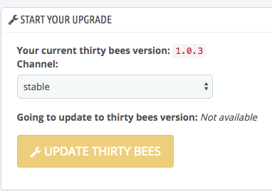

@Traumflug is it possible to allow backups if an update is not available?
Updater used to have this option before it backed up 12 million files ;)
Was so excited to see this especially the parts added by @musicmaster so I just installed it hoping to do the backups like I used to months back.
But the update button doesn't work if you are current so I couldn't test it out :(
Please? :pray:
But the update button doesn’t work if you are current
This is intended behavior :-)
But I see your point, not only for a module test run. Merchants may want to refresh their installation, for example after they changed code manually. I'll see what I can do about it.
If you can't wait, you can fake the installed version in config/settings.inc.php line 14. That's where the current version is defined, just change it with a text editor.
Like changing PHP define('_TB_VERSION_', '1.0.3'); to PHP define('_TB_VERSION_', '1.0.2');

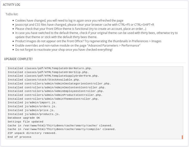

As promised, I looked into these refresh-upgrades. It's not easily implementable. Upgrading doesn't mean to simply unpack a ZIP file, it's handled file by file along a list of file actions. And there is no list of actions for a refresh.
Nevertheless, this research triggered quite a chunk of additional commits. Things more tidy now, (hopefully) more understandable messages. Temporary files get removed after being done. And this "warning notifications have been found" HOAX on the final screen removed, there is no code which could issue such warnings.
I can also confirm that faking the version (currently) leads to backups. However, the backup thing built into the upgrader module means to allow version rollbacks, not fixing broken installations.
cPanel (or file copying or another backup tool) backups are better because they can be restored with a broken shop installation, too. Being able to restore a broken installation is pretty much the point of backups, isn't it?
Here's the now prettified final screen:

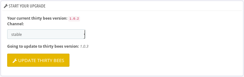

I can’t click update button now?
After lowering the version in settings.inc.php the panel with the update button should look like this:
Note that 1.0.2 above and 1.0.3 in the lower text differ. In case the update button is still disabled, please add a screenshot here.
Looks ok.
